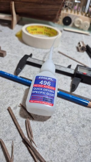

I discover for myself oiled CA. This is the same CA with small quantity of oil.
This “set” don’t spread, but worked fast and hard. Of course, if you apply too much glue, it will live some sign, but reasonable quantity invisible.
I use it not only with rigging, but with wood, when I can’t use clamps. 10 second, live fingers and let it dry about half an hour
Source Temu. Ask oiled glue.

Thank you... what kind of oil: mineral, petroleum ? Wouldn't gel CA function the same as oiled CA?
Here is one possible choise
I know these, very liquid. I use the same and buy it in a local store. 3x 3ml tubes just 70 cents. But don't use the plastic tube. Use the needle like I mentioned in post 7. I bring a drop of glue on a little plastic card and dip the needle in. The drop will be liquid for about an half hour to one. Depends on the temperature in the room. The needle can be cleaned with a lighter. Just burn the needle and whipe it with a cloth. Works perfect and never too much glue.
