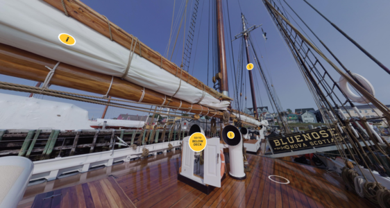

I have done an exhaustive google search and I want to find out what this part of the ship is. I am working on the Bluenose II. I have seen these on other ships and they appear to be to drain water from the deck. Eventually, I want my ship to be realistic and it sems they may need to be drilled out, but I am not sure how many of them are needed.
The things marked "i" on the deck is a ventilation funnel. They were used in the days before motor powered fans blew air below deck for cooling. When the ship is moving, air is forced down the funnel below deck. The small house with a door which leads down below deck is a booby hatch. Yes, it's a funny name and landlubber chuckle when I say it, but that's what it's called in English. For draining the deck of water, there are tubes along the bulwark leading from the deck down and out the side of the ship. These are called scuppers.

The tall, free standing vents on the deck can also be referred to as cowl vents. Some may have a water trap and drains at their base — to prevent spray that blows into the vent from going down below.

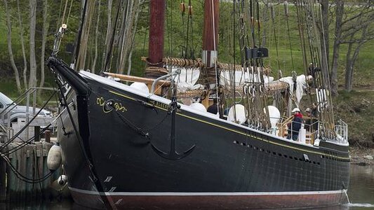

When I ‘googled’ “Bluenose scuppers” I got many many pictures. A lot with different interpretations on different models, but also a lot of the real BN-II. Like this one:
On the lower fore-deck, there are 16 scuppers. On the higher aft-deck, when I have counted well, 28. They are between the bulkheads and just above the deck.
