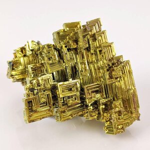

there are a several alloys like tin/bismuth or tin/lead or zinc/bismuth and other
bismuth when cooled will turn all sorts of colors like gold, blue, reds yellows and greens. and it can be re-melted and cast over and over.
i do not know exactly what Corel or any kit manufactures use but most likely a tin alloy.

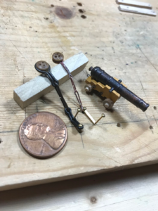

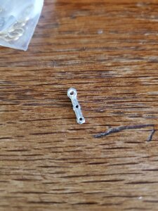

its the fittings for the deadeyes, they are about the worst castings i have seen , nothing lines up and the mold lines are off by at least 1/2 a mm which on something small is horrendous, they are a whitish metal which i thought might be tin and it melts at a lower temperature than lead free solder, i wanted to try and make the bottom fittings again and if it doesn't work i will cast them in brass
if they are whitish then my guess is a tin alloy pewter
here is a tin bismuth alloy Bismuth melts around 500 drgrees
I am not sure how the colors are controlled but looks like you can get any color you want from Bismuth or a Bismuth alloy
yes this is exactly what i am working on too, the main parts i am making from brass wire the piece that attaches to the hull is a cast part , the one in the picture is one of the good ones but not accurate for my ship so i wanted to make one that was a little nearer to what it should look like using the extra metal i have with the deadeye surround , i still have one more piece of wire to make , it looks to be exactly like yours

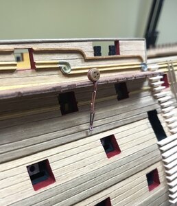

Well that piece you want to cast I had same thing in my kit. I consider it totally out of reality. Actually it have to consist of 2 separate parts. I plan cutting the part which is a piece of metal making it a double shear connection (one attached to the hull body) from sheet brass. Look at this picture.

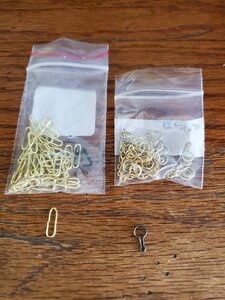

yes mine is almost identical to yours but my castings are terrible , there are a couple that haven't formed properly so im short any way , that's why i thought i'd have a go at making my own , i just got through making the long part that is joined to the dead eye and i am going to start making the short piece , once that is done i will solder them together , how are you going to blacken your pieces?

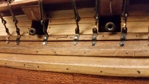

Let me suggest not to casting deadeye chains? Make them from copper wire. This is exactly what I work on now.

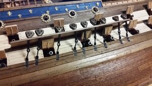

I would suggest using brass wire instead of copper because it is stiffer. If you do not solder the ends of a chain link loop closed, and put enough tension on the parts, copper links will open up. You can blacken the brass, but when I do it, using tools to work the brass caused the blackening to flake off. Instead of re-blackening the chainplates, I just painted them carefully after they were installed to cover up the shiny spots.
Before painting....
After painting...
