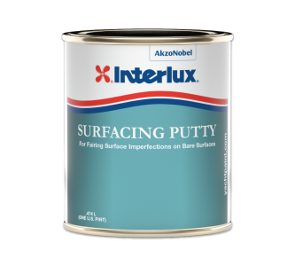

When the faired wood hull is sealed and the shellac dry (virtually in minutes), open seams and major imperfections can be addressed. There are specific materials for this. The best products are found in automotive paint stores where the local body shops get their materials or in well-stocked yacht chandleries (not the ones that are more interested in selling sunglasses and "yachting togs.") This stuff is called "surfacing putty." It is a creamy material made up of very fine "whiting" (powdered chalk) and acetone. It can be thinned with acetone. The acetone dries very fast and this stuff can be applied out of the can at the consistency of toothpaste to fill larger seams and divots. The acetone-based surfacing putties will harden in can quickly if you leave the top off, even while puttying. It is easily reconstituted by adding a tablespoon or three of acetone to the can at the end of using it and replacing the top tightly and then turning the can upside down and letting it sit overnight. No need to mix it in. The new acetone is simply absorbed by the material in the can. Apply the toothpaste thick material with a small flexible putty knife or better yet, a palette knife from the art store when working on scale models. (Cleaning your tools with acetone is a lot easier if you do so before the putty starts getting hard. a dirty putty knife isn't smooth and so is useless for the purpose for which it was intended.) When the putty is dry, and it will dry hard very quickly, sand it fair and smooth using 320 grit sandpaper on a sanding board. It's very important to sand curved areas with a curved base to your sandpaper. Otherwise, you will sand "lumps" and "bumps" into your surface.
Is my go-to surfacing putty, primarily because I've used it for decades finishing high-end yacht hulls, as has everybody else in that trade. There's other brands as well. They probably cost lest because anything "with a boat on the label" costs twice as much, it seems. The auto painting shops I think have surfacing putty from 3M that comes in a tube like toothpaste and in some sort of spray cans, too. Probably at less cost than Interlux from the chandlery or online. It does go a long way, though, and you can keep a can "healthy" by adding acetone as needed to maintain consistency. (I guess it's like taking care of sourdough starter. :) )
Needless to say, don't use acetone with a cigarette dangling from your lips. Use in a well-ventilated space. Read and follow the instructions on the can. Don't whine about the "fumes." Work smart and you'll live. Painters have been doing this for every.
The beauty of surfacing putty is that it is made to be sanded very easily. When using it, sanding becomes quite satisfying, rather than a nasty chore. Apply the surfacing putty conservatively. Fill the divots and dents to the level of the surface. There's no need to pile up gobs of it y9ou will only have to sand off later. If there are widespread areas of minor imperfections, you can thin some of the putty and spread it thinly with a brush. When it is dry, using a "sanding board" again, fair the hull overall using 220 grit abrasive if there are major areas which must be faired, then finish using 320 grit over the whole hull.
