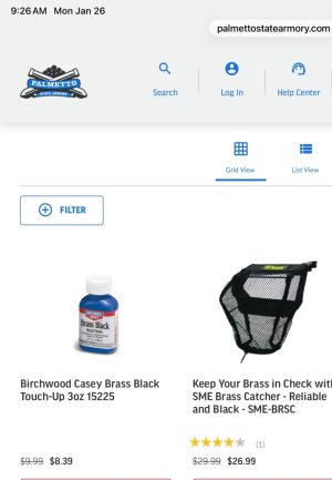

Here’s the stuff on the Palmetto State Armory website. Add shipping and it’s about the same as Amazon. The crazy thing is, I go to the store and it’s out of stock and they don’t know when they’re getting more.
I know this is a minor thing but it was bugging me. I guess the shortage is just local. Ah well, c’est la vie
