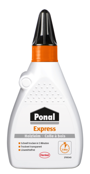

Here in Europe the modelers are often using the wood glue from Ponal, a prodcut from Henkel
Ponal Express is my usual white glue I am using, btw waterbased, so you can unglue easily when necessary

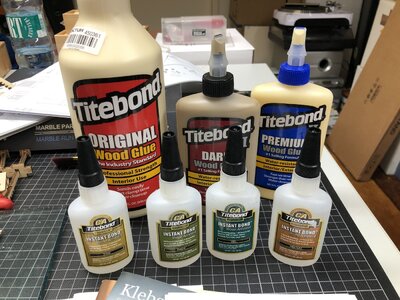

But I am also using the products from Tidebond, regular the CA-glues are very good

Hi Michel, for the most part, all PVA glues are mostly the same. PVA stands for Poly Vinyl Acetate, they are homopolymer emulsions. However, based on the abbreviation above, D3 is a water-resistant standard, it is specially formulated to conform to EN 204 (D3).
OK, I do not know the glue standard. They have too the D2 version, may be this one fit better ?
D3 is mostly used for outside woodworking projects as it is water resistant, while the D2 standard is for inside-use projects. D3 and D2 are just standards, and how they hold parts together you may have to try. I like trying different glues for different jobs. Maybe you will be the first who try it?
