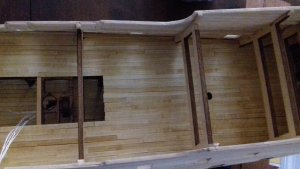

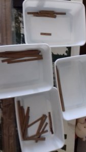

Gonna work a little bit onze the wilhelm in between. Until now in have the hull with first planking. All the cannons painted. And some stuff if the decks are planked. The second deck is already glued in but not planked. Stupid but True. ....

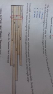

Gonna plank the decks and gonna do second planking onze the hull. Cut some pieces of wood for deck and want to use aan sceme for it. See pictures

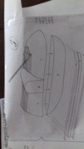

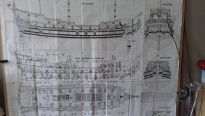

Tnx . Gonna work from the plans and some scratch items. Dowloaded and printed about 209 pages from the built in 3 levls. The normal built and the experiant and expert. Shall see where it end. ....

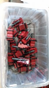

My occre kit is more dissapointing. Lot of wood damaged some parts for the stairs missing. Cannon ports missing. Cannon headges with only 1 pin to fit in ports instead of 2. Gonna write them again with pictures.

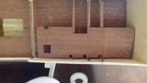

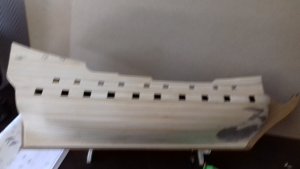

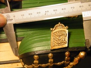

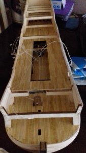

Well did some deck planking. Have to make some gunports at the hight of quarterdeck. Dont know if i have to do the other 3 decks first and dryfit them and then cut the ports or first cut the ports. And after that the second hull planking.

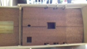

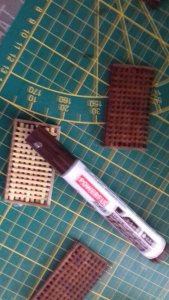

Mainframe deck. Going to put the cannons at the gundeck now i think. Is space availeble now and then close maindeck with crates. WorKing in livingroom nowwith airco too hot in my shipyard now my morfinpatch is comming off in 2 hours there.

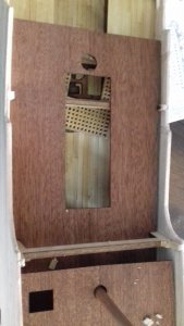

Today made all the decks to fit.have to change a lot. The man who in bought it from has instalt the frame not so nice. Also the gunports are about 5 mm of.made all the crates for every deck. Have to cut out some cannon ports now i can see if it is at the good hight now decks are in shape.foto's are from the decks that didnt fit.

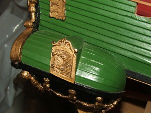

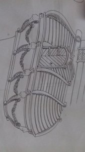

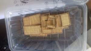

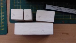

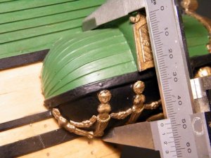

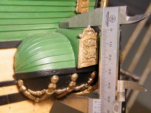

Ik have decided to make the cabine first before i start with the second planking. I dont want to glue it on the second planking but make the second planking a round the cabine. Its also to see if i can make it because if the cabines fail i cant Go further because aan ship without nice cabines is a waste. After that i am gonna plank the other deks and place the cannons i cant reach any more if the decks are installed and work my way up with the second planking of the hull with the decks i put in place .
How high is Your cabine? Thought i made the cabines in good shape and lenght only forgot to make 1 as Mirror so had to do 1 over again.
Yes it had real wood planking on the cabin, it's just an easier way to do it with the cardboard,
