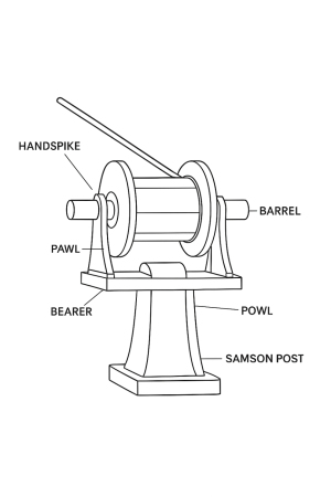

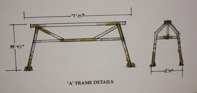

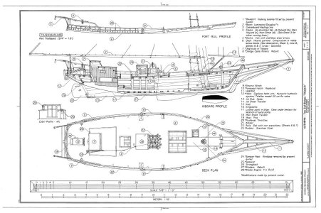

I am looking for design details for a windlass whose axle is attached either to bitts or a samson post as in the attached figure. The attachments for the windlass brakes are shown on the ends windlass but not how they would be supported or where the pawls would be located.
  • Traditional Windlass Designs:
    On many 19th–20th century sailing vessels, the windlass axle (or barrel) rested in bearings either on the forward bitts or on a dedicated Samson post. These bearings were often cast iron or heavy hardwood cheeks with iron straps, bolted through for strength.
  • Sources for Drawings:
    • Howard I. Chapelle’s books, such as “American Small Sailing Craft” and “Boatbuilding,” often include detailed windlass sketches.
    • The Smithsonian Ship Plans collection sometimes has separate windlass plans for small craft.
    • Model ship forums or archives like Mystic Seaport Museum sometimes have measured drawings available.
  • Typical Mounting Details:
    • The barrel turns in gudgeons (U-shaped iron brackets) bolted to the Samson post or bitts.
    • The pawl rim and pawl posts are on the deck in front of the barrel to prevent backwinding.
    • The handspikes or levers insert into sockets in the barrel or drumheads for manual operation.

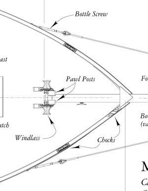

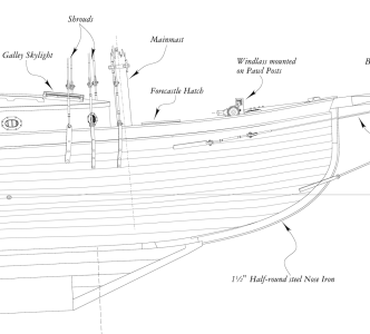

I came across another drawing of a bitts mounted windlass but it again omits the mechanism that actually turned the barrel which is what I am looking for. Chapelle is the best reference but it is for a different kind of windlass.Screenshot 2025-08-24 at 11.16.15 AM.pngScreenshot 2025-08-24 at 11.10.20 AM.pngnce for details I have found but
Your skipjack is a relatively small craft so the windlass was a a commercially manufactured item probably bought from a local ship chandler. Both drawings that you posted show what little mechanism that there was. The diagram that Jim posted shows the same thing.
If you look at the drawing posted immediately above, there is a rectangle sticking out behind each of the windlass heads. This is a socket for inserting a hand spike. Within that semicircular shoe on the forward end of the socket there is a ratchet mechanism. This allows the hand spike to engage the sprocket attached to the Sampson post on the downstroke, and disengage from it on the upstroke. The external pawl also engages the sprocket to prevent it from rotating backwards.
The windlass on your skipjack drawing works on the same principle except the hand spike sockets are on the outboard ends of the windlass drums with the large sprocket and pawl separate.
All of these windlass designs would have been patented, many of which are posted on the internet.
Roger

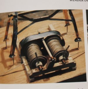

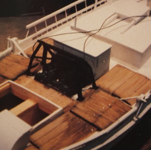

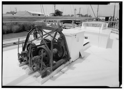

The winder (a term from St. Michael's boatyard that I learned) boat yard drawings of a skipjack at the Smithsonian) has a frame on which it rests plus an A frame over top of it. As you are from Washington Crossing maybe consider a day trip to St. Michaels to see a full size skipjack. It's about 2.5 to 3 hour drive, but quite pleasant and the crab cakes at the Chesapeake Landing restaurant in St. Michaels are some the best we ever had. I hope they are as good today as they were back when we were there. I have no idea if the boat yard is doing any rebuilding right now, but when I went there many moons ago, they let me take a good size piece of an old keel that was being replaced which I used for building two skipjack models.
From the Library of Congress --- There may be more photos and possibly drawings on their website.
The 3 pictures below are from The Skipjack by Steve and Patricia Rogers, a book on building a skipjack model.
Thanks for everyone's help on my question regarding the windlass. I thought there must have been more than shown on the plans but Roger's explanation of how it would have been hand cranked indicates that was all there was to it.

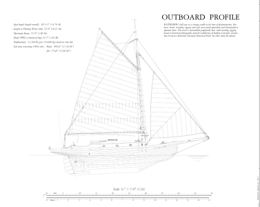

I am actually building a model of the yacht Kathleen (1904) (shown below) that is in the collection of the San Francisco Maritime Park. I just learned they have some photos of her that I hope I can get copies of to answer questions about the deck fittings. If I am sucessful I will post themn here. Screenshot 2025-08-25 at 9.40.59 AM.png
