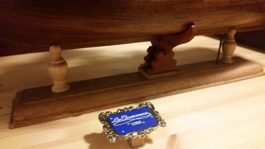

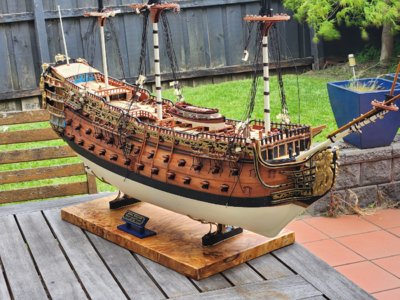

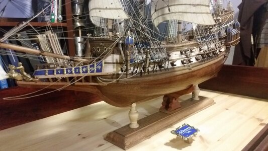

Making your own base and routering the edges is what most builders do.

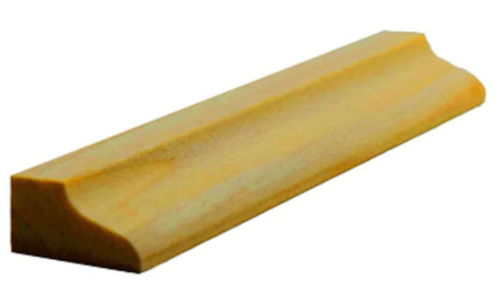

If you don't have a router, cut a rectangle of wood and surround it with shoe molding. Miter cut and glue the molding of your choice around the edge of the base board. Choosing the same type of wood and finish will make the molding and the base board look like one piece.
1701148672393-png.410085

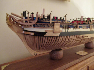

What I use is a straight board from Lowe’s (Hardware and lumber company). They are sometimes signed as hobby boards. I can choose from pine, popular, oak depending on how I want to finish the board. Of course the edges are a straight square finish board…I am not concerned about shaped edges. I get a board the size I need for $3 (price depends on wood and size of course) stain it, poly it, and mount the ship. Looks good in the end…just not fancy. Here is a partial photo of such a board base. PS: that is the LauckStreetShipyard model “Kingfisher.”

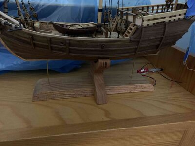

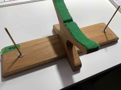

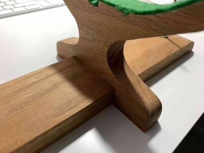

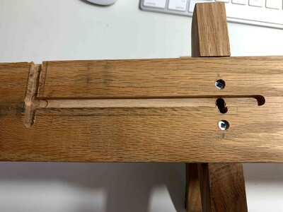

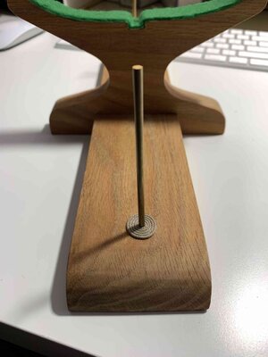

In my opinion, no need to spend to much for a base; it should just hold your beautiful model and not be a focus point...
Here are my bases; a piece of oak, lightly machined and just danish oil... green billiard table cover, still need a bit work.. Ropes are covering bigger than needed holes for 3mm copper wire.
Bottom has channel for cables as my Santa Maria will have some led lights installed...
Bellow base need a bit more work.. currently just holding Pinta waiting for sails..
Happy modelling..
