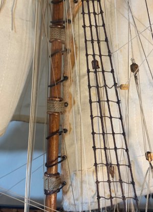

When wrapping the rope around the mast you get a start point and an end point this creates a small step, I've seen models where there is no step just a perfect band of rope with no apparent start or stop, how is this achieved ?

If I remember rightly, you make a loop with both ends pointing down. The loop itself is pointing up. Use the long end of the string to wrap around the mast and the loop 13 times. Poke the end of the string through the top of the loop and cut all but a little of it off. Then pull the other end of the string down until the loop is covered by the wooldings. Finally, cut the string with a sharp blade at the very bottom of the wooldings. No one will ever see it.

Ropes bound tightly around the mast were known as wooldings; they were intended to help strengthen the lower mast. Their number on the mast differed according to the ship's size. Steel recommended eleven on the mainmast for large ships and nine for Frigates. Other sources speak of between six and nine.
Steele also specified that each woolding should consist of thirteen tightly wound turns, with each turn nailed to the mast. To prevent them from cutting into the woolding, the nail heads were underlaid with pieces of leather.
Timber hoops1/1.2 in wide were usually fitted above and below the woolding, nailed to the mast, and slightly greater in thickness than the woolding rope. Mizzen masts were fitted with wooldings after 1730, normally two fewer than on the foremast, but the mizzen mats of small ships remained without wooldings or iron hoops until the end of the century. Some large ships may have been fitted with mizzen mast wooldings by 1700 or even earlier.
Strong iron hoops were driven on to strengthen the mast structure. These Iron hoops came in to use mainly in the second half of the century, at first together with mast wooldings. After 1800 wooldings were no longer used.
During the first half of the Century, iron hoops were only used on the masthead, and the mast itself was strengthened by wooldings. Some models of the large ships from before 1750, however, provide evidence of some use of iron hoops on the masts as well, either in place of or together with wooldings.

Hi, I have a question about the wood above and below the wooldings on a mast.
The red arrows are the wood pieces.
Is there some kind of a trick to create these things?
The size is about 1,0 x 0,5 mm and the diameter of the mast is 12 mm.
I tried veneer from swamp walnut (0,6 mm thick)
But that was no success in making
Tips are welcome.

Hi Steff66
By my model Dolphyn -Corel i used thick copper electrical wire . They can be blackened or painted in a wood color and essy to work with.
