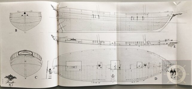

thank you Dave its a schooner french 1823......La Jacinthe
Do you have the planset of the La Jacinthe made by Jean Boudriot?
Here included is also a detailed decksplan with the planking.
