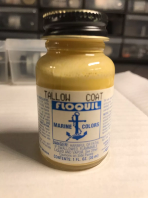

Wrong Paint kit with Model

I still have a collection of Unopened Floquil paints. One bottle is Santa Fe Orange. The bottoms of many Great Lakes steamships were painted with red lead, Before the zebra mussel invasion anti-fouling was not much of a problem.
I think if I add a little red ad grey I can come close.
