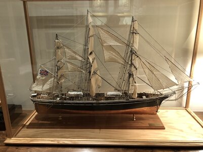

I did fore to aft and deck to top. Pre threading the blocks at the deck eliminates a difficult passage. Lou
