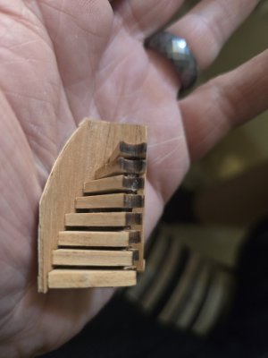

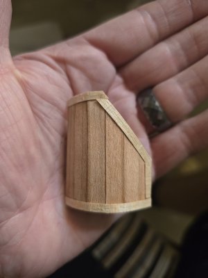

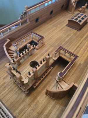

These little staircases are tricky. It's not as simple as stacking them up; the stacked stair treads alone won't sit flush with the decks they lead to.

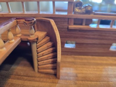

I had to insert 1mm strips of wood between them to get the 34mm required to reach the next deck. I also used a wood veneer cigar wrapper with finishing strips glued to the outside to create the "wall" of the steps to give them some rigidity.
I still need to add a railing to these steps, I think boiling some more strips to curve them will be needed.

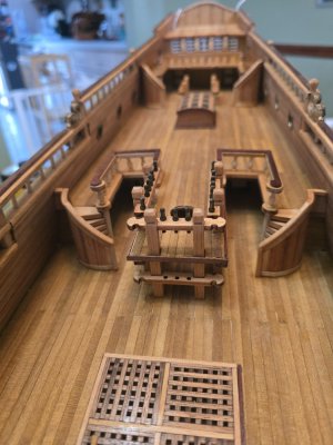

6 sets of these steps will be required for this build. 1000026390.jpg1000026389.jpg

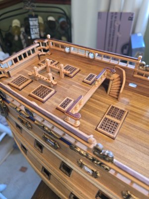

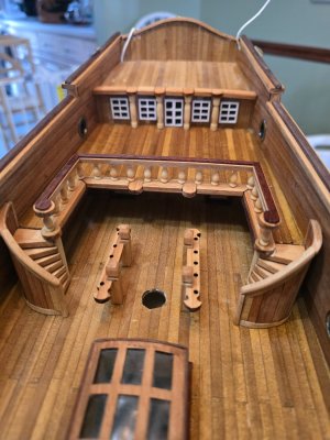

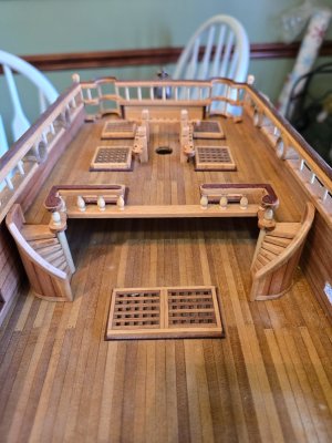

My goodness, these stairs and railings were tedious. I'm really happy with how they turned out. It's exciting finally seeing pieces go on the deck, it's been virtually empty for a year! I finished the other sets of steps as well, but they still need to be installed. Thanks for looking!
