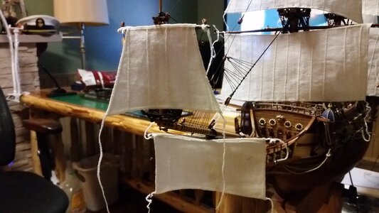

Test fitting purchased sail set. The stitching at the edge seams doesn't have an accurate appearance, and some of the sails were a tad too short in width on the yards. There are no bolt ropes or loops at the clues, so you would have to add those.

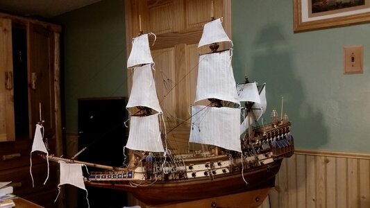

Test hanging purchased sail set.

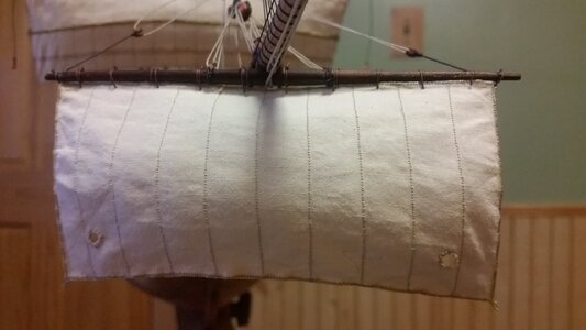

Comparison. This is a home made spritsail. Because of the small scale, the bolt rope around the periphery was only glued with PVA to the edge of the sail, not stitched, and the bolt ropes include the loops at the clews and cringles. The panel lines were sewn with the smallest stitch length that the sewing machine could do.

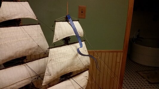

Comparison: this is how home made sails appear. My build log showing the process of sail making begins HERE.
