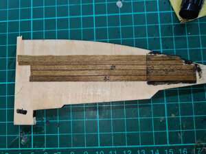

So after some suggestions on here I decided to do another test lot of deck planking before moving onto the real thing. I liked the end result that @Brewbrarian suggested as a technique for the treenails the best so did that as a larger test piece. Here are the planks laid, drilled and then sanded. I also used a black pencil rubbed against the sides of the planks to simulate the caulking, which is hidden slightly on these planks due to the sanding.
First coat of oil went on and left to seep into the timber and dry. I put a piece of masking tape over part of the planks just to see how much oil would seep underneath it. I am used to painting plastic models where if you mask something off there is usually little to no seepage underneath, so was interested to see how much it would change with timber.
The image below is after 3 coats of tung oil (letting it dry in between coats) and I am really liking the finish on it, not only the colour and depth it brings out of the teak, but also by how nice and smooth it it to touch. Also turns out that the oil does seep under the masking tape and into the wood quite a bit. Good bit of info to know! I also don’t think I sanded enough off to create enough dust in the holes to fill them, but looking at the effect by eye and not magnified by a camera it looks good.
It was now time to mark up the main deck and decide what pattern to use for the deck planking. I know that this ship build isn’t going to be 100% historically accurate (I haven’t set out to build it that way), so I decided to go with the pattern I liked the look of the most, rather than researching which one would have been completely accurate for that period or this ship. Also from the reading I did do, it seems as though some of the time the patterns or lack thereof was determined by what timber was available when building the real ship and where the bulkheads happened to line up too. Without having exact plans from the original Soleil Royal or pictures to go by (not that photographs existed back then), we may never know what is 100% accurate or not. I guess that is also part of the joy of building these historic ships, some of it is completely up to your own interpretation.
I decided on the 5 plank pattern as the staggering effect of the joins was the one that was most appealing to me. I have left the plank length at 120mm for the main deck. This is the length that the teak strips come in with the kit. For the other 4 decks on the kit I am going to cut the planks in half so they are only 60mm long, which I think will look better on the smaller decks and allow for the pattern to still show.

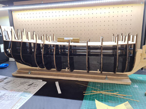

Been a little while since my last update. Transitioning back to onsite work and training up someone to take over part of my role has left me exhausted at end of the day, so my modeling time has been very sporadic. The work below is a culmination of about a fortnight of modelling time.

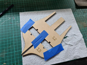

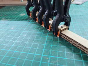

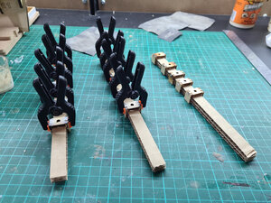

Time to prep the gunport rails. Simple joins with some timber across the join for support then set aside to dry.
While they were drying I installed some of the planking for the various walls and supports that would be seen on the decks. After gluing and laying the planks in place I clamped some spare timber against them to make sure I got a nice flat finish and so they didn’t peel off as they were drying.
After a nice trim and the 2 doors test fitted in place it looks quite good. I am toying with the idea of running a few led bulbs inside the model so that I could give a sense of life inside the ship. Of course the 3 main lanterns on the rear of the ship will be lit, but it might be nice to light up the other windows and doors around the ship too. If I do go down this route I’ll glue some roughed up plastic to the backs of all the openings to give them a frosted look.

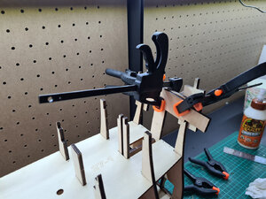

It was now time to install the front bulkhead on the ship. After looking at a couple of other builds on here as well as the French museum model I decided to put a bend in it. The museum model has one and it looks quite nice. So after multiple soaks in hot water, I gently persuaded it to fit. I held it there for a few days with a multitude of clamps and some brass rod to help it keep its shape while it dried. Once it was dry I removed it as I had some other work to do around the bow before it was to be glued in place.

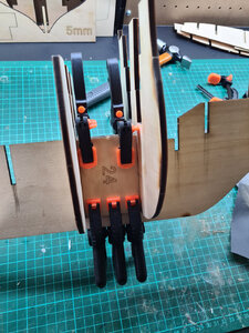

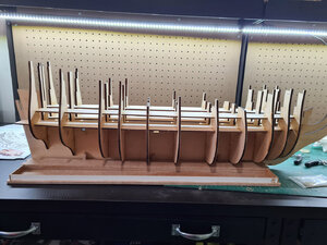

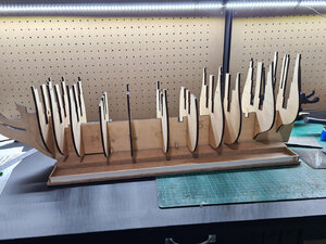

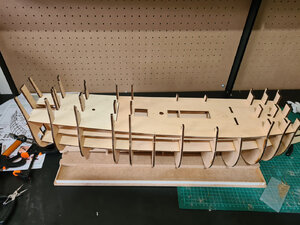

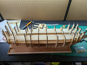

Next was time fair the bow and stern bulkheads. ZHL had provided some laser cut lines as a reference on some of the bulkheads to show how far to sand, but I found that only sanding to these points did not do enough, so I kept sanding and test fitting a piece of the planking until I was happy with it.

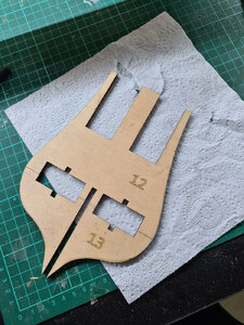

While I was fairing the stern, it was also a good time to take care of the deadwood area. After looking at a few builds on here, as well as some other instructions on the process of sanding down the deadwood area I decided that I would notch out a section of the keel to allow the first planking to sit in. The great thing about the 5mm plywood that was used for the keel is that it was 3 layers thick (which can be clearly seen on the sanded bulkheads), so I was able to remove one layer from each side. I know that it is normally standard to only remove about half the thickness of the keel timber, but it was easier for me to remove 2/3 of it, and it will also mean that the first planking will not need to be sanded down as thin.

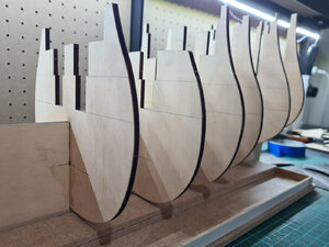

I also installed some balsa wood blocks at the bow of the ship to help keep form when bending planks over it.
Here is one of them roughly carved to shape.
And here's a nice smooth finish and curve too.

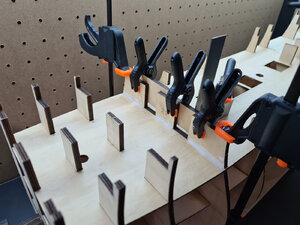

The last thing to do before installing the front bulkhead was to rework the front gun ports. If I had left the bulkhead flat as per the instructions then the supplied gun port boxes supposedly would have fit behind it but as I decided to bend the piece I had to come up with my own solution. Some scrap 2mm timber marked up, drilled and glued in was my fix! It was then time to glue the bulkhead in place.

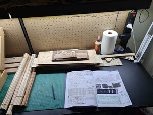

Yes that’s right, its another ZHL Soleil Royal Build Log!
Hi all, and welcome to my first build log here on SOS.
Time for a little backstory.
I’m primarily a plastic model builder, more specifically a sci-fi model builder but I bought the ZHL Black Pearl early last year to add to my stash of kits to build at some point in the future as I really like the ship (both from the movies and from the Kingdom Hearts video games) and really want to make a statement piece out of it.
Fast forward to this year and being in lockdown, I’ve had a bit more time to model but due to a few setbacks, I lost my drive for the couple of plastic kits I had been working on so they have gone back in their boxes for another day. I looked through my stash to see what else I could dedicate my time to and I saw the Black Pearl sitting there, but I knew that having not ever built a wooden ship model before, I didn’t want the Pearl to be my first. So I started looking at other wooden kits I could buy to be my ‘first’ build.
Knowing what I can be like, I had to make sure that the ship in question was one that I was drawn to and was of some interest to me. So this is where I stumbled upon the Soleil Royal. I know it is technically nowhere near a beginners kit, but if I’m honest, none of the beginner kits I looked at appealed to me. I just like the look and shape of the Soleil, along with its colours and decorations, and I like a challenge.

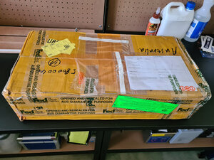

So I took the plunge and bought it. Max was great to deal with and the kit eventually arrived earlier this week.
Looks like Australian customs decided to inspect inside the box, but thankfully they didn’t have to confiscate anything.

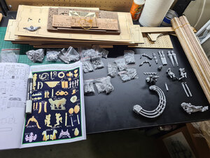

After a quick inventory, everything was accounted for apart from the Instruction CD appearing blank when put into my PC. Sent an email to Max and haven’t heard anything back as yet, but luckily paulb was able to help me out and email me a copy of the instructions from his build. Thanks again Paul!
So after sitting down with the instructions and looking through the parts, I’ve decided that along with building the ship (which is a mammoth task in itself), I am also going to look into the possibility of replacing the metal decorations that come with the kit. Whilst the ones that come with the kit are not horrible by any means at all, I am guessing that over time the molds used to cast them have worn down a little so they have lost some definition. I recently bought a 3D printer to be able to create custom parts for other model kits and thought I could put it to use on this kit too. Now whilst I have some experience in creating things in a 3D software program, usually they are very boxy and are not carved or sculpted as such. Venturing into this new avenue of sculpting and carving things in 3D should be a bit of fun, and if it fails, then at least I still have the original metal ones to use!
If you want to see a full breakdown of box contents head over to the thread from Dematosdg linked below who has done a great unboxing of the kit.
ZHL- LE SOLEIL ROYAL 1:90 - Box Content
Anyways, I’ve already made a small start on sanding and gluing some pieces, so I’ll be posting again soon with my build updates.
I know I have a lot to learn (both about ship building and also all of the correct terminology) and will no doubt make mistakes along the way, but that is half the fun of it.
Hope you enjoy the build and my journey!
