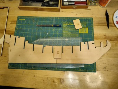

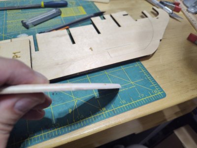

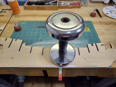

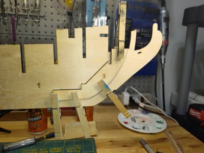

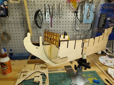

First things first, the keel and center frame has been glued up. It's a two piece keel with blocks "P1" that get glued on both sides to strengthen frame. The wax paper was to prevent me accidentally gluing the frame to my work bench. This is my first time experiencing this type of keel. First impressions of this keel is that I'm not a fan of the keel and center frame being all one price. I'm going to see what I can do to make it more authentic, as the instructions just show to plank all of it.

Small update for today. Just minor shaping and starting to lay the frames into place. After I installed the front bulkhead on the bow, I've realized there's not much depth for installing and mounting the bow spirit. I'll have to add some blocking and drill it out after working out the correct angle. Granted it also will rest on that support right in front.
Did you know that Lego's work great in a pinch to square your frames? I've used this in the past with good results.
The details on the bow are also laser cut, so they're looking a little rough. I'm going to try and see if I can smooth it out with some diluted wood filler.

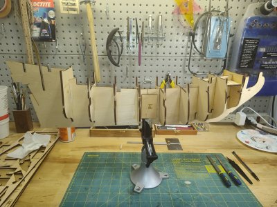

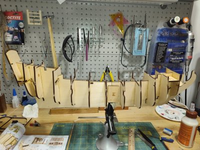

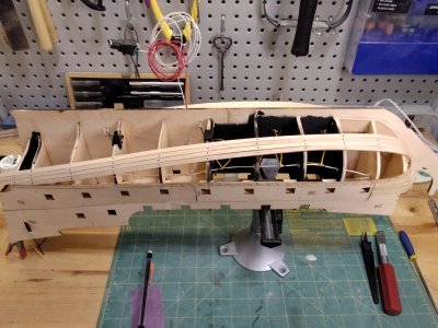

I had some time in between yard work over the weekend. I was able to get most of the frames installed, hopefully the rest will be done later this week.
The instructions showed to bevel the frames to a laser engraved line to help with planking. I'm thinking I should have waited until everything was together. I can see that more shaping and wood filler may be needed to fix frames 4 and 5 to match the keel and not make the planking misshapen. But we'll see when we get there.

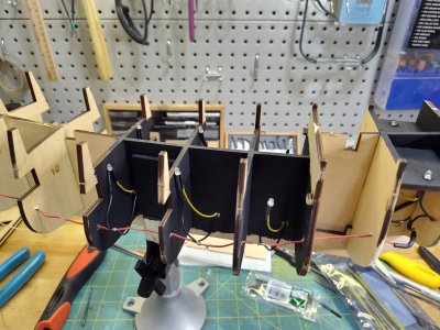

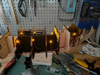

I finished the framing and can now move on to installing the decking. I'm now to the point where I need to plan and install the lights.
But the light that came with kit are just LED's with spool of bare copper wire. I've ordered some LED's that will "flicker" to give the lights a more lantern look to them, so I'll put a test together before I fully commit to the lights. I'm still not 100% sure that I even want them to be honest. I have a kit-bashed Ghostbusters Ecto-1 model I did a couple of years ago where I went through the effort to add lights and wiring and I've once or twice turned it on since I finished the model.

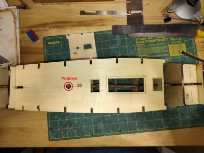

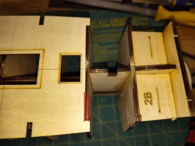

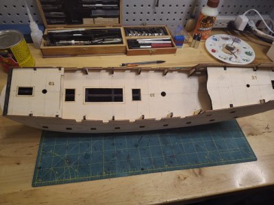

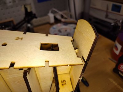

Found my a couple of issues with this kit last night, and they center around the main false deck. As assembled the false deck is around 1/16" too long. But I think it has something to do with the center line of the keel, where the two halves are glued together. It was fairly loose when I did the dry fit, so I pushed it all together tightly before gluing. Everything seems to deviate from that center point. Meaning all the notches line up forward or after depending on the center line. So I'll need to modify the deck to get it into place. As the main mast hole is also off, but will need to evaluate as I lay down the false deck.IMG_20250416_003226094.jpgIMG_20250416_003334768.jpg

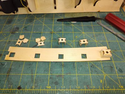

Another issue I found is around how the main and aft false decks are installed. The instructions made no mention of not gluing certain frames, and I wish I had the foresight to not glue a couple of the frames into place so make installing the false deck easier. There are tabs that need to fit into the frame. and it would have been easier to slide those frames into place as I lowered the false deck. Currently I can't do that with the notches cut out for the other frames and having to bend the deck to install.

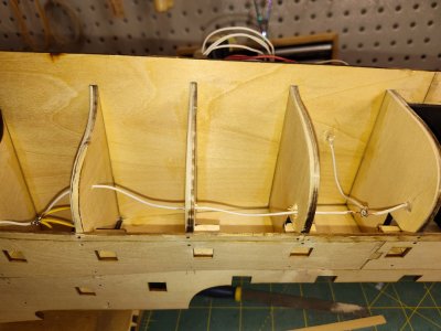

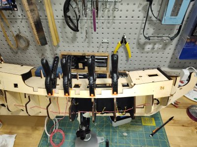

I had a couple of days this weekend of being able to work on the Pearl. I spent most of the weekend planning and laying out the lighting. I ordered some 12v flickering LED's to give it more of a lantern lighting effect. I'm ditching the included light kit and batteries and moving to a plug that will be mounted into the base and hidden.

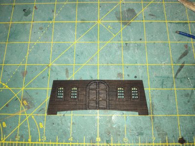

I have the false decks installed with some tweaking to make fit right. I ended up having to remove the tabs that fit into the already glued in frames, as there was no other way to install them without breaking the deck. I also did a color test on the captains cabin wall. The Black Pearl was originally the Wicked Wench before she was burned and sank. So I don't want the ship to be all black, but I want some browns to show through. I stained the walnut a deep brown (first photo) and then did a black wash over the top and blended in some light gray (2nd photo). For the cabin doors, I used some eyebolts from another kit to make the door rings.

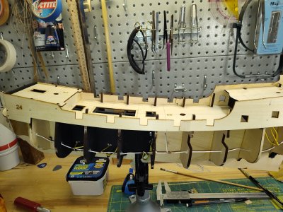

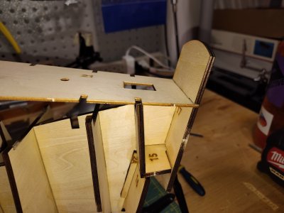

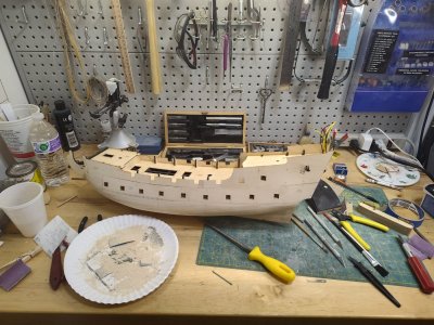

Next up the side plates were added. The fit and glue up is a little tricky. The frames that show above deck are to be cut out later per the instructions, so glue contact was minimal across the decking. And the frames showing above the wall aren't an issue because they will be cut flush with the deck. Since there is a joint in the middle of the plate, I glued in a patch of wood to clamp and mount flush with the intent that it will be sanded down flush.
I had to "fix" my sanding error on the forward frame. The instructions stated to remove material down to the laser cut line. but once I installed this, it was clear that lines would be off for planking. So I pulled out the wood filler and reshaped the frame to reset it. I should have waited to fair out frames after it was assembled. But it was the first time doing a new ship in 16 years so I was little excited to get started.

I wouldn't say that there is an overall issue with parts not fitting correctly mostly the keel being about 3/32" to short and the domino affect that has caused. The biggest issues are the order of operations and lacking instructions and detailed plans. But I'm up to the challenge.

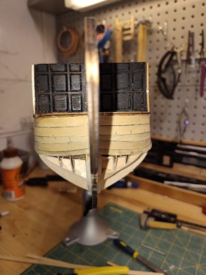

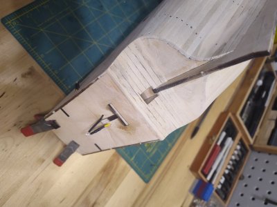

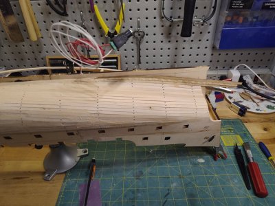

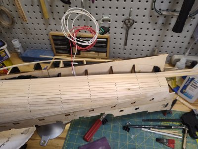

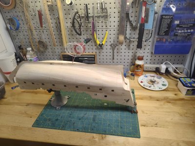

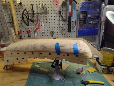

Planking has started and moving at a snails pace, and fairing the frames is one of my least favorite parts of planking. But I'm chipping away at it 5 minutes here and there and it's coming along and not abandoned.

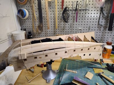

Summer is over and the mountain bike team is almost done for the season. So I'm dusting off the workbench and I'm starting to have some free time again. This is really what 5 months of progress looks like when I spend 5-10 minutes here and there. I've been testing some different wood fillers to see which was strong or what sanded down easy. That will come in handy once I'm ready to start final planking. Thanks for looking.

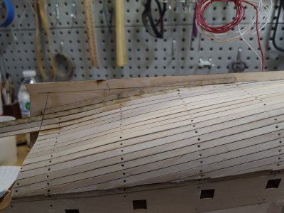

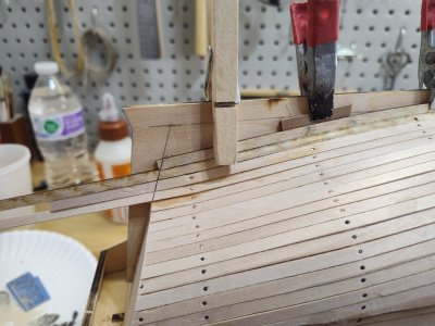

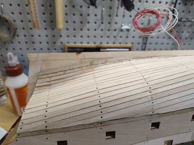

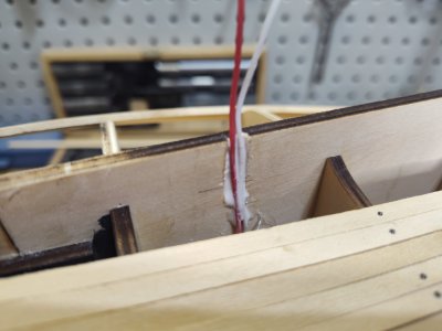

It's a slow grind working on the hull. I'm going to finish the right side and figure out how to best do the left. I notched the keel for the wiring, as I'll pass the wiring through a support into the base when the time comes. At this point I'm not a fan of the keel as it was designed. I'll do my best with planking but I need to find some wider walnut planks for the keel.

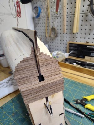

In preparing for the final planking, I've painted the gun ports black as well as the seam around the keel. I started on the stern and the hull will follow shortly. I'm trying to commit to at a minimum of 5-10 minutes a day of bench time. some days I hit it, some I don't. But I'm trying. Hopefully this one won't take longer than a decade to finish.
