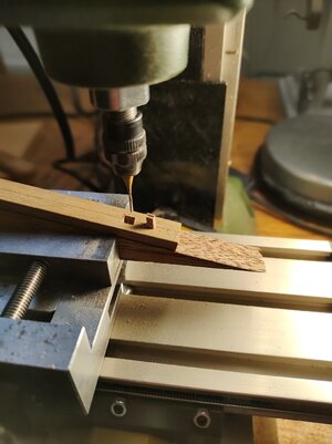

To make it I attached a bit of 10 x 4 mm walnut using double sided tape to a piece of scrap cut at 12 degrees, the angle I took of the original t.d. of Speedy and Flirt found on the Greenwich Royal Museum web site, then using my smallest 0.8mm cutter and my little milling machine I cut out a 4mm square and drilled a 4mm hole for the jibboom as you see it turned out a goof fit. Tomorrow I will turn the three bowsprit components and finish the bowsprit. I am going to use cherry rather than the walnut dowels that came with the kit as I don't intend to paint them and I like the colour.

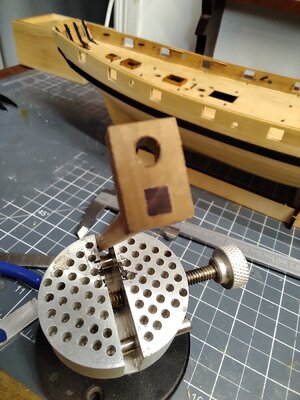

Although I feel that things have not moved on much this last few days I am content that I have got the fore mast top pretty much finished as it proved to be quite challenging. After setting up a temporary main stay I was able to determine where to attach the heart blocks to the fore mast and bowsprit.IMG_20220113_091710.jpg
The kit comes with dead eyes here but to my eye closed hearts look better.
Then it was on to the top itself, the laser cut parts to build this are quite delicate and needed care not to damage. Hanging below the top platform are 16 blocks, 14 a fiddley 3mm. I experimented with connecting them with heat shrink black banding and while this looked very good I was not sure the blocks wouldn't pull out when a bit of tension was added to the rigging, so I abandoned the idea and tied them on with 0.25 black 'rope'. For the four most visible that are attached to the back, although it doesn't show up too well in my pic's.,( only have phone camera ) I used a very fine served length of rope.
