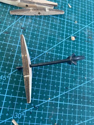

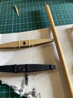

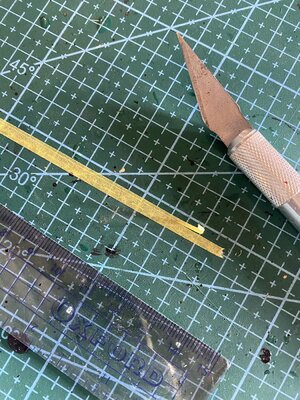

I made the anchors- not too much change from plans- the bands on the stock I used tape cut to size rather than rope. I first used cardboard but these band were too bulky as in photo. I seized the brass ring with 0.25 thread and stained black with Indian ink. I also rounded the end of each stock and used exacto blade and sanding stick to shape these.
The hole on the stock where shank goes through had to be shaped bigger and oval as the head of the shank is bigger than the shaft. To fill the hole I used tape wrapped around prior to gluing the stock.
I am debating adding the contrast seizing (3per anchor ) on each ring.2639C345-F16A-4E30-93FF-B61A71A6AD78.jpegF9B1F5F0-0240-41C0-A30E-827753EF8354.jpeg357DF18F-03C8-44F6-8452-249D7618B3F2.jpeg6DECFF89-4C6D-4BD3-9EC8-70A4DF39BBB0.jpegE8103F0E-C9D5-434E-8021-5AA5E565C042.jpeg

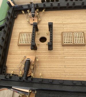

Good evening. Here is my construction of the galley chimney. I made it per the kit with following additions.
I used 0.8mm brass wire and 0.2mm wire to make the handles, the hinges and simulate the cover on the top of the “exhaust “ (for a better word?). Masking tape was cut again for the weld line and the band at the base. Needle files were used to shape the chimney. Dry fit.For The base I used a 1mm rectangle and again reduced the size and height from the kit. The jury is out on this and will see on my return. Have an awesome weekend all. Cheers
A very interesting observation after I built this- my gratings are not to scale or the chimney is too thin. I used the kit measurements for both these and it is way off from the kit design. I will not be changing these.
Mantua really seems to have gotten their sizes haywire on some of the fittings. Your exhaust looks so good, but the base diameter definitely seems to be too small when compared to the real McCoy. Oh boy ...:confused: it never stops, does it?
I think you’re doing great! You can’t expect every aspect of the ship to be spot on to scale. I know they have the real thing to look at in the Victory, but being able to mass produce something to scale would be tough. That’s why we get to improvise and create our own interpretations of the ship. Sometimes I think that’s where the real joy of building begins.
Hello Heinrich. You are correct. I have seen many modelers go for what I have done tho. I think my gratings are too far apart rather than the chimney base being to small....or a bit of both. We shall see. The Sergal kit I got is a really old one so I wonder if the panart is better in this regard. Cheers
