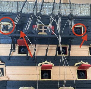

First is my closed gun ports- as previous discussed I forgot to add the gun supports for the top stern row (only 4 thankfully). Had to do some creative thinking.
I made 3 attempts at making a jimmy gun support through the gun port itself and lost all three into the depths of my hull- Eish. I then cut a 8x8 Plank of wood, drilled a hole for the cannon and epoxy glued(with “nails”of CA) onto to the bulkhead of the cabin walls. This worked.
For the most stern gun port there are no bulkheads to glue to so I made a window(with curtains)ROTF from the etching left over and made a cannon through the window. (A little builders license). Had to cut the cannon to a third using my dremel.
I think these are better- added the hinges for the quarter Davits- arrows. The gun port lids will be added after I complete rigging here as I am sure I will break them off- finesse not part of my repertoire.

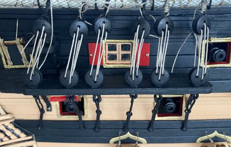

Here is an interesting point- my shrouds which where tensioned have stretched. Luckily I did not tie off the lanyards as I want to fit the stays first so everything is tensioned correctly. I think I will do the same for the other mast shrouds where I leave them for a while prior to tying off? Let them stretch and sag a little too first.
I’m not sure if this is normal or it is just the quality of the thread provided?
Hi Grant,
I did a lot of research about ropes while figuring out how to make my own and I learned certain materials change with changing humidity levels. Did you install them in dry winter and now its humid summer for you? Could be that? Perhaps wiser friends can help.
Hello Paul. It could be that- they did go in at the beginning of summer and we have recently had some very hot humid days recently. The begging question is then: when one tensions the lanyards do we make them tighter depending on seasonal changes or just stick with the norm ? probably thread dependent as well.

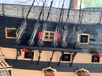

Loving the window with curtains Grant! Gives a false sense of security of a homely, safe and domesticated look and feel. And then a large black cannon suddenly protrudes out! Brilliant ROTF
