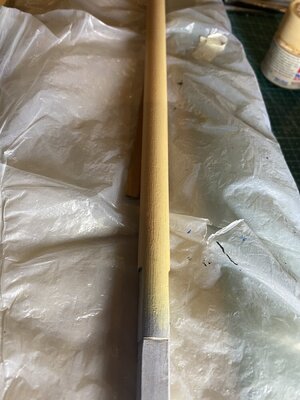

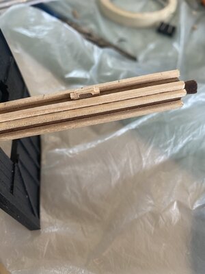

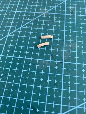

Good morning. The main and foremast are under construction. Mainly per instructions other than the upper parts where the block supports and jeer block lashing parts added. Also added more mast bands. As I made the Mizzen previously.
13C6F809-2881-40D6-BB9E-EF89B9198BA4.jpeg410348A0-CC07-438B-B100-BAF25D227C29.jpegDBEDDF06-E617-40A0-B026-25CC8F548D37.jpeg3BD724D3-16F1-4132-B673-24305CD0E5E0.jpeg11FC1CF7-23EA-4743-A4AD-6CE2FC97F07E.jpeg

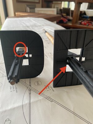

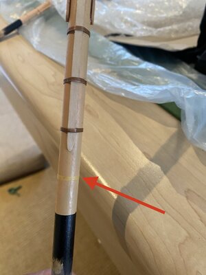

Arrow and circle - I ran out of copper for mast bands (boy this kit gives no extras) so made one from Tanyia masking tape cut to 2mm. I don’t think this is thick enough tho.
I left space between the cap supports and the rear of the crows nest for the shrouds to fit contrary to Instructions which show these must be flush against the crows nest. (Obviously no supports in Instructions). I had a problem (correctly pointed out by @Daniel20 ) on my mizzen with this.
The benefit of posting photos on this site (the circle). It has happen a few times with this build. Shows my oops which I will have to repair.
