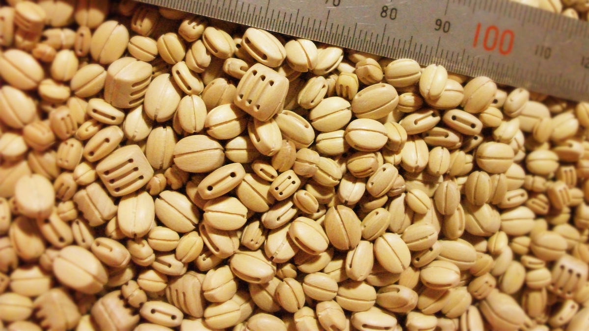

No update on ship, but I've been preparing stuff for my next build. Almost all of blocks on Luis are bought or modyfied on already bought parts. In future I'm planning to do Le Superbe in 1/150. I'll need 2mm blocks so there's no option of buying. Here are my first attempts of making it.

Buying it isn't a problem SZKUTNIK has 2mm singles and dubles. I bought a milling machine among other things to make pulleys. 2mm ones are the hardest, 3+mm are no problem. They look good and are easy to make.
So I've read many tutorials and topics on making blocks and here it's my version of it.
Very important thing in such small blocks is quality of wood. In previous I used walnut. Pear is much better.
What you need(tools):
1.Milling machine
2.Table saw/mini guillotine
3.Dremel type drill
3.Milling cutter 0,5mm
4. Drill bit 0,4mm
And patience;)
Pear strip is 2mm thick, 3mm wide. Lenght doesen't matter now.
1. Forming strip into round-ish shape
2.Cutting strip to 2mm pices.
I have a chinese saw just chaneged sawblade to proxon's 0,5mm blade for better precision.
3. Milling block
I use 0,5mm milling cutter which is already broken. It's not a bug. It's a feature:). Even if you happen to have new one you'll break it, so don't
throw it away.
After making grooves I put it on the end of vice and drill holes. Next step milling other side of pulley
What I get is 2x2x3 pulley (width,thickness,length)
In comparision to 1/100 Heller Victory's 12punder gun
I hope it will help someone.
Cheers
Couple of triple ones. Unfortunetly they're too big for shifting backstay and too liitle for lower yards halyard. I didn't make lower holes because material is too frigile. I've also strengthen wood by soaking it in wood glue mixed with some water.
