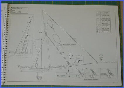

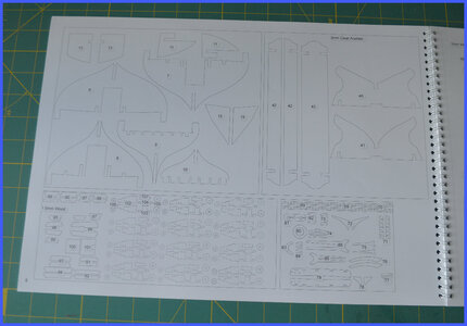

Received this kit in the mail recently and was so impressed with the instruction manual I thought I would begin with it.
The manual is a 55-page wire wound color illustrated booklet.
The booklet measures 17" x 12" of heavyweight paper with excellent color illustrations.
One of the most comprehensive instruction manuals I have seen.
I'll begin with images of the manual and later will delve into the component parts.
If the manual is indicative of the rest of the kit, I look forward to the build.
The following are just a few of the 55 pages.
