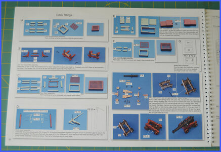

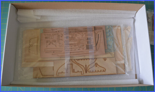

Received this kit in the mail recently and was so impressed with the instruction manual I thought I would begin with it.
The manual is a 55-page wire wound color illustrated booklet.
The booklet measures 17" x 12" of heavyweight paper with excellent color illustrations.
One of the most comprehensive instruction manuals I have seen.
I'll begin with images of the manual and later will delve into the component parts.
If the manual is indicative of the rest of the kit, I look forward to the build.
The following are just a few of the 55 pages.
03_Instruction Booklet.jpg04_Parts List 1 of 2.jpg05_Component breakdown 1 of 4 pgs.jpg06_Assembly illustrations 1 of 20+.jpg07_more pages.jpg08_more pages.jpg08_more pages.jpg09_Rigging 1 of many.jpg
Ok, part two. Time for the good stuff :D 10_First Layer.jpg
First Layer Packaging

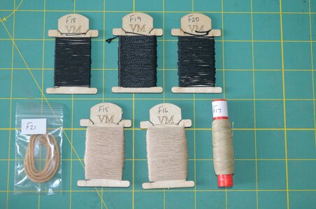

Threads

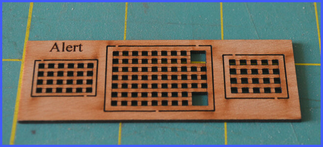

Optional Pearwood Gratings

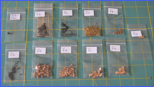

Fittings Package

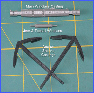

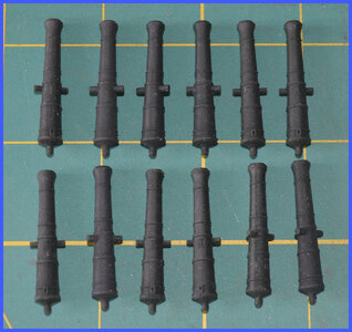

6lb Cannon Barrels Resin Cast
Second layer Packaging

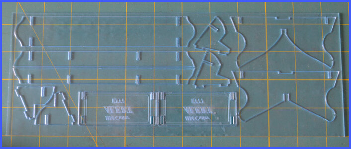

Acrylic display Stand

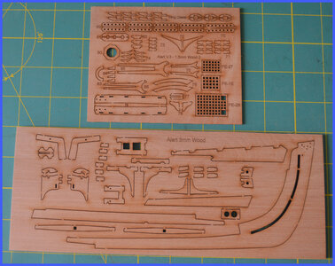

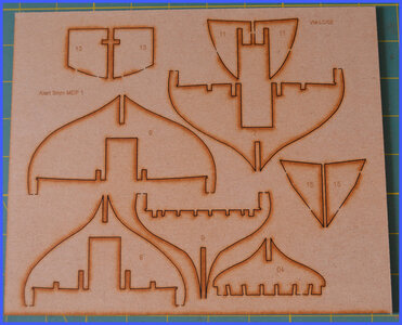

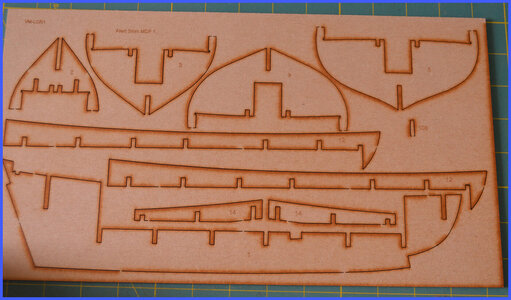

3mm MDF Frame parts, false keel, bulkheads etc.
More 3mm MDF bulkheads

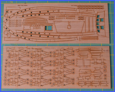

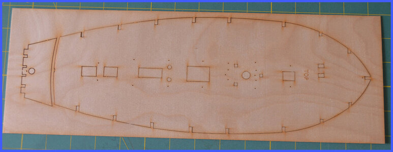

Main Deck 1mm Plywood

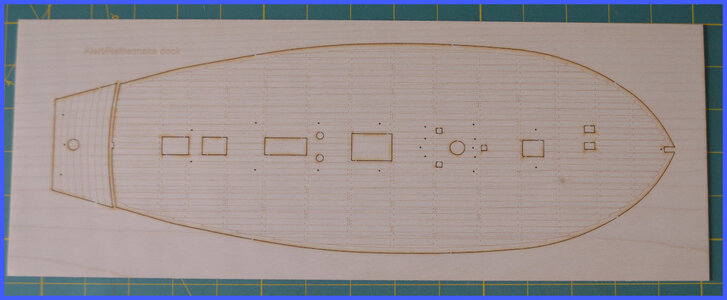

Main deck Pattern 1mm wood

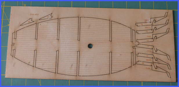

Lower deck Pattern 2mm MDF
Stempost, Keel, misc., wood

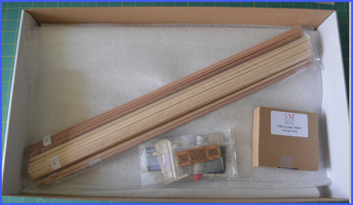

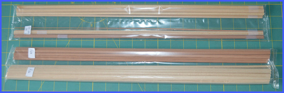

First and second planking strips, (Limewood & Pearwood), Dowel stock

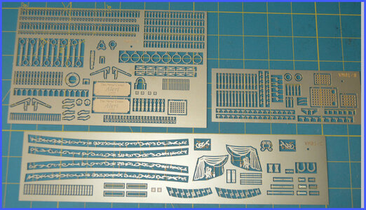

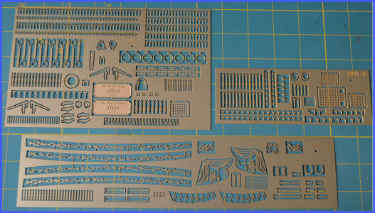

Etched Brass Sheet
Additional Brass sheet

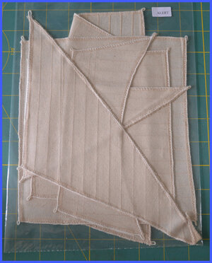

Pre-sewn sails
All materials look to be of quality. The milled planking strips are very clean and consistent in size.
Dowels are straight and true.
The only downside for me is I dislike MDF. I know the pros and cons of MDF vs. wood however, that's just my opinion from my
experience building.
Otherwise, this looks to be a very good kit and should be a pleasure to build. (Now if I can just find the time)
They could have done a better job of the gratings. I suggest ditching the pre-cut sheet and making the gratings from one of the many parts kiits that are available.

f.e. is now the deck planking a sheet with laser marks. If you do not like this, especially at the small quarter deck (wrong grain direction) - is there enough strip material for the "hand-made" deck planking?
I guess it is double planked, are the hull planking strips wide enough for the clinker planking? The planks should overlap, so therefore they have to be wider than usual. Or is it planned to make no clinker, but cravel planking....

BTW: You have two photos with brass sheets (which are looking good), at the second you write "additional brass sheet", but the photo is showing the same like before - Did you get two sets?

In general, it is a good kit which will make a nice model. Obviously, there are things that should be considered for improvement. My biggest 'cons' are the rigging blocks. Those supplied in the kits are a way of average quality. Similar quality rigging blocks have been supplied 30 years ago in Mamoly, and Panart kits, and still. However, there are many companies making rigging blocks today with quality much, much better than in the kit supplied. Ironically, VG is selling the blocks from The Falconet, which can be supplied in the kit, IMHO.
@rtibbs if you would decide to upgrade your rigging blocks, I would highly suggest DrydockModels and Parts. I guarantee you will never regret the choice.

Hi Ron, I built this kit a couple of years ago and it goes together quite well, the only thing to be aware of are the thin MDF parts used in the stern as, if forced, they break very easily. I agree that the rigging blocks that come with the kit are old fashioned and in fact they where the only thing I changed. I thought that the pear wood gratings where quite nice and more accurate that after sales mini kits and even the etched brass ones, once cleaned up and painted. work as well. I hope you enjoy the build, my feelings are that the quality of VM kits are higher than most other European companies.
