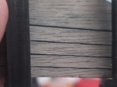

I played around a lot with deck finishes... and went with a process learned online from a shipwright at Model Ships. A combination of isopropyl alcohol and Indian ink and scraped graphite.
I like the gray tone and contrast with the walnut ribs as well as the ability to create traffic patterns and darkened areas with the graphite. It seems to get lost in the pictures but looks great in person !
