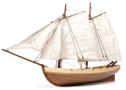

Pic for reference, not my build
The Bounty boat will be a good start to get some experience with planking and other important construction methods
I found another photos showing, that this model has also some more details to show (and make)
