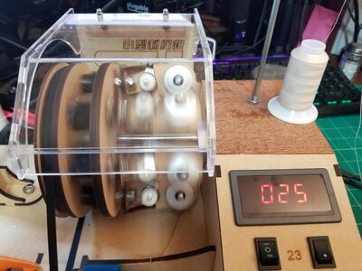

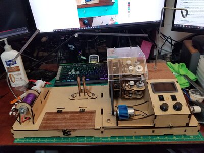

I just got this in the same day I got the Bonhomme Richard. The first thing I have to make clear is I have never done rope making and have only a rudimentary knowledge of it so far. That said I got it all assembled and running. I tried to lay the veneer but lost interest after a couple pieces, just not something I felt like spending time on, though I am sure it would have made a beautiful addition once glued, sanded, and varnished. During assembly I ran across two issues. I glued down the take up motor bracket too early, this was one contributing factor in not laying veneer. You have to lay the veneer first, then glue the bracket down on top of it. Oopsies.
Other than that, I could not get my infrared sensors to work to run the spool filling system. I also didn't like the idea of letting only the machine shut the spooling motor off. I removed the infrared sensors and rewired it so that the momentary switch now controlled power to the motor. It shuts off when you let up on the switch. The spools fit very loosely on that shaft, too. I have to hold them against the shaft to get them to turn. Something I'll have to address. Anyway, here's what you guy's want to see, some videos of it in action. First two are shorts, third is 2 minutes long.
First off, regarding the thimble spooling system, yes it runs fast but it also fills those thimbles very quickly, too. I would like to add a rheostatic switch to control speed, though. Second, if you fill the whole spool with smaller thread, the machine will run for and hour or two before it runs out. So if you are using smaller thread, only fill it halfway or less. As near as I can tell, the thimble mounts are geared at 2:1 counter turns per rotation. I am not sure that is enough to counteract most thread twisting. That along with a couple of malfunctions during processing resulted in throwing out quite a bit of the rope I made. There was still some good stuff, I used some Gutermann but it was smaller than skala and tera. I tried laying all six cables, but one thread wrapped around the thimble shaft and broke very early. About 10 minutes in one of the other thimble mounts worked loose on it's gear shaft and wasn't rotating at all in comparison to the head. That's when the rope stopped twisting right and started to unravel as soon as I released tension on those parts. I ran the machine for maybe half an hour or more and I think the middle gear on the main shaft had it's set screws come loose. The whole head had a tendency to walk out of the blacks the shafts are mounted in because they don't clamp down very tight on it. If you push it back in by pushing against the edge of the head with something frictionless, the whole thing can get really quiet, but most of the time it's pretty loud. So I need to do some modifying there.
Here are some of the planned fixes I intend to implement:
- Drill some small holes in the main shaft to allow the set screws to bottom out in them, that way, if they work loose, there is still interference keeping the gear from turning on the shaft.
- Find a way to clamp the main shaft tighter in it's support blocks so it can wander out.
- Do something about the thread spooler to make the thimbles sit more tightly on the motor shaft.
- Add a rheostatic switch to the spooler power supply.
- Figure out how to keep the thimble mounts on the head to stop coming loose.
- I'd like to try to do something about the shafts for the thimbles on the thimble brackets. Maybe find a good shoulder bolt for them.
- I'd also like to replace the gear shafts for the thimble brackets. They are currently aluminum all thread that is hollow. Might be hard to find a better solution.
- I'd also like to drill the center of the main shaft so I can add a core thread. I think I have a way to do it.
