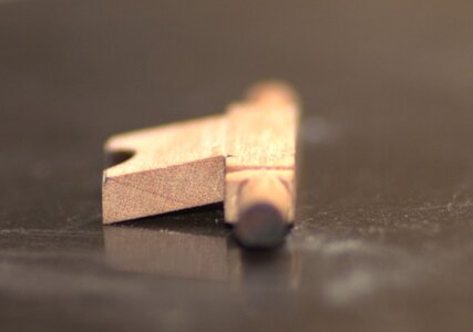

The parts for the carriage are provided in two laser-cut Pearwood sheets. Each kit will have a thinner sheet, that contains parts for left/right marriage sides, all 4 trucks (wheels), transom, and bolster. The thicker sheet will have front and rear axletrees and quoins. Below is the sample for the 35mm barrel.
I am removing all the parts to clean the laser char where it is required. Some parts will require shaping before they are assembled. Let's start with both axletrees. For the tracks to fit, the axletree ends require some rounding.

I start with the transom, it will be glued to the front axletree. Please note the two laser marks., you will glue the transom between those lines like so on the images below. You may click on the individual image to see a larger view.
Moving ON, time to glue the carriages' side pannels. Each carriage has notches to accept the front and rear axletrees, also there are laser marks on the axletrees to position the sides. Glue everything together including bolster. NOTE: you will have to shape the bolster so it will fit between the carriage's sides.

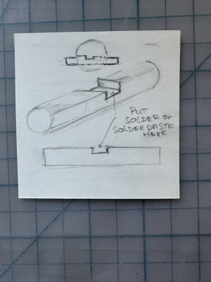

First, I prepared the wire. Using the carriage, measure and cut slightly longer wire for trunnion, so you have enough for the final shape from both ends.
As you can imagine the trunnion (wire) should be perfectly fit in to the barrel's hole. So... The actual question is where to put solder? Obviously, the only way is to put solder from the sides, correct? Yes, but then, you are risky that solder 'jumps' on top/bottom or any other place but not inside, between the trunnion and hole. So, I decided to mill a groove and put the solder there, in this case the solder will melt inside the barrel and guaranteed not spilled across. In the middle of the trunnion part make a grove half of the diameter of the trunnion wire (see the sketch below)
Put some soldering paste and insert it into the barrel. Remove any excess solder from both ends and... Solder it. Heat the fatty part of the barrel first, and evenly spread the heat toward the thinner part of the barrel. You should see the bright solder between the hole and the wire. The job is done! While still hot, dump it into vinegar to remove oxidation.
