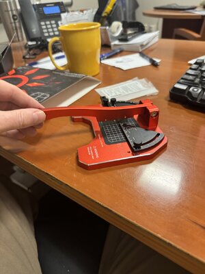

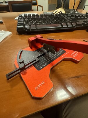

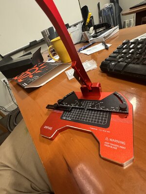

I was a little suspect when I ordered the DSPIAE cutter from Aliexpress but I have to say I am in love with this little cutter. I have the Amati cutter which is plastic and not capable of getting consistent, repeatable cuts due to it's design that allows the handle (blade) to move side to side. This unit is way better and is a solid, mini cutter. What I like:
1)This thing is solid. Everything is made of aluminum and very well put together....no plastic parts.
2)The guides are all metal as well, clearly marked, and accurate. 45 angles are a breeze with this cutter.
3)Razor Blades are the standard, single side blades that you can buy anywhere. All you have to do is drill 2 holes in blades to match the blade that comes with the unit. I setup my jig and drilled 50 blades in about 30 minutes....I like to change blades often.
4)Well designed. Cutter is designed so that the actual cutting is about an inch or two from the base of the handle. The result is that there is no pinching or "scissor effect" from trying to cut from the base of the handle...the blade comes down in a straight angle to the wood. The result is the cleanest, sharpest cuts I have ever gotten.

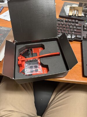

5)Price. I paid about 60 bucks all in with shipping, etc. It took about 2 weeks for mine to show up and I was very impressed with the packaging.
Honestly guys, this is a great little cutter. If you like or make due with the Amati cutter, you will love this cutter.

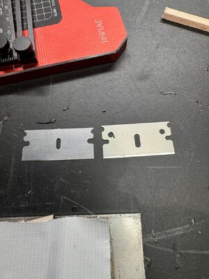

Here is a comparison of the blade that comes with the unit (on right) and a standard single edge razor you can buy anywhere. (I removed the metal top or cover that comes on standard blade....it just pops off with a little prying) As you can see, you need to only drill the 2 holes and you will have infinite supply of cheap blades.
