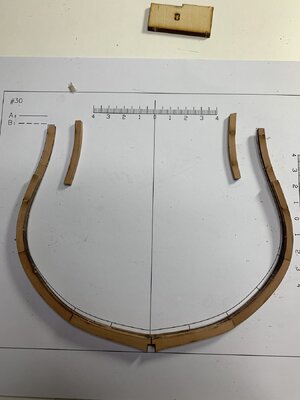

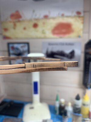

Hi all,
I have started the above POF kit and have completed the keel and have started on frame #30. I have completed it (apart from the last two top parts as Seen in the attached picture) and I am slightly confused as the upper parts are 3mm thick but the last two top parts (which I have not glued in yet) are 4mm thick. Is this correct? I have checked and double checked and I have removed the correct #30 parts from each of the 15 planks that contain the frame parts. Please see my picture below.
Thanks,
Iain

Yes I saw those drawings which is why I am confused as the two top parts are 4mm thick and not 3mm.

Hi, I actually fully understand how to assemble the frame, I am just questioning why the last two upper timbers are 4mm thick instead of 3mm. I’m pretty sure that all the other parts of the assembled frame in the photo are in the correct place according to the drawing. I will ask the owner of the company as he is on this website.

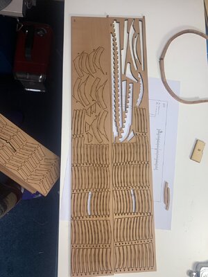

I would check, if the 4mm top timber parts are maybe by accident lasered in a 4 mm wooden sheet.
Maybe it is a mistake in the production - than you would have several other parts cut in a 4mm sheet

Thanks, it takes me about 40min to complete a frame, probably half of that time is sanding off the laser burn from both the in and out sides of the 15 parts of the frame. Will take a bit longer when I come to the frames closer to the bow and stern to sand the curvature.
