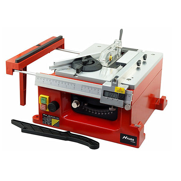

By the way. Guys. This micro-mark model looks exactly as Proxxon FET but had a ripping fence with no seeming problems as Proxxon saw has. Fence looks simple and reliable. Does anyone owns this model? Could they share their opinions about this model. If I did not own a Proxxon FET I would probably took a risk buying this saw. Today it is also much less expensive to Proxxon.

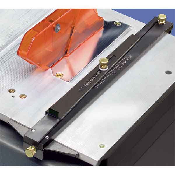

G'day YT, I had the Proxon Version which is Identical, great saw, when I bought the proxxon saw I went to Micro Marc and also bought the this fence for it,
This fence locks at both ends and has a sliding scale to allow to adjust for the widths of cuts, The saw has I said is identical to the Proxxon ,
hope this helps you,

Thanks, neptune. This fence is "temporarily out of stock" at micro-mark site which normally means forever. Can you clarify? Do you own a Proxxon FET or a Micro-Mark which looks like ProxxoneFet?
I did have a Proxxon exactly like the Micro Mark one which has the variable speed control,
