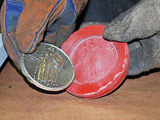

Yeah.... I goofed a little with the molds. Looks like I made a wrong silicon mix in terms of proportions between part A and part B, and the mix started to cure and thicken too quickly. This led to small bubbles being trapped underneath the cannons. Luckily, they are relatively easily to remove from the castings, just some additional work to do...
Hi. I'm curious about the outcome with no vent relief in the mold. Male plugs are awsome, btw. Let us know! Cheers.
Oleg,
Have you tried making the cannon molds in a single piece rather than two halves. It eliminates the seam where the two halves meet. https://shipsofscale.com/sosforums/threads/making-cannon.14545/ post #4.
I'm not familiar with the mold material that is flexible enough to remove the casting from it when it is one piece. In the thread you mentioned, I see that liquid resin was used fos casting (not metal), so it may be that such flexible material cannot be used to cast metal. And I prefer metal cannons, so the silicon has to be able to withstand 200--300 C.
