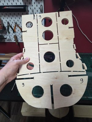

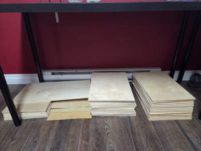

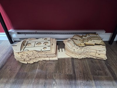

I think I need to start slowly transforming this pile of plywood into frames. If I want to sand the dummy hull outside, I better hurry cause it's middle of the summer already. So I either finish it by say October or I will have to sand it inside the house or wait till next summer...

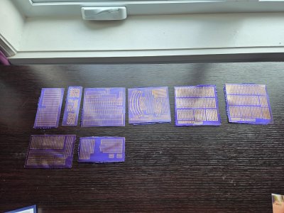

However, there's another thing that I need to do outside and before colds... all my photoetching works. I have all the templates prepared already. Here are couple examples - I have total 13 sheets like this to etch, with brass thicknesses 0.2, 0.3, 0.4 and 0.6mm.

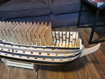

The scale is 1:48
about the process, it might be easier to explain later with other photos and at the time of assembly itself. the technology is similar to what i used on the royal william, but with some modifications. this is POB. first a plywood structure is built from these 30 frames. the frames are not finished yet, pear inserts need to be glued to them, they will represent the vertical sills of the gun ports. the gaps between the frames will be filled with linden inserts. after the external planking, the middles of the frames will be broken out, leaving only the shell above the gundeck
