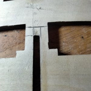

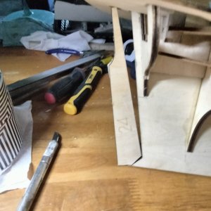

I got frame 12 removed. I was surprised to see that I had not made a mistake by not fully seating the frame into the keel slot. In fact, it appears that the slot is approximately 3/8" too short to allow seating frame 12 far enough.
See pencilled area in the photo

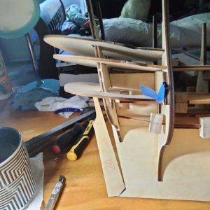

The rear deck elevations at the stern are critical as the foundation of the ornate balustrades and rails.
It appears that I might have been mistaken about believing that the elevation of frame 12 was incorrect.
The plans don't provide a side view showing the relative angles of the three decks at the stern.

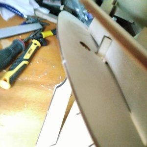

After unglueing, sp, frame 12 and trying to get part 49 into place it seems I need to bevel the upper portion of the opening to get proper alignment.
I had been under the impression that the three deck pieces should be in parallel. Now I'm not sure.
I'm going to fit all the deck pieces in place and go another step forward to gainare critical confidence before glueing.

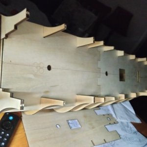

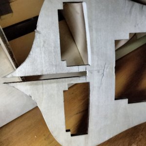

Something is really wrong here. I already trimmed the front of part 51 to move it toward the bow but the rudder. If I slide part 51 aft the gap at the front is much larger than the amount I trimmed.IMG20251020092659.jpgIMG20251020092652.jpgIMG20251020092646.jpg
Im not confident on the three stern deck levels and their angles. I'm also not confident about the dummy gun locations on these three levels. I'm tempted to glue in the main deck subflooring but afraid it will just make more work, or rework.
