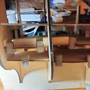

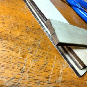

Adding .5 x 4mm shims to each end of the next upper deck supports. That's parts 7B to 12B to make up for the parts being to short to fit snuggly.
This 1mm shortage is the only time on this build where the parts didn't fit perfectly.

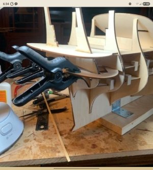

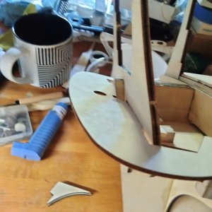

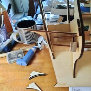

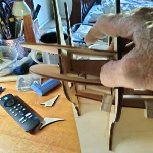

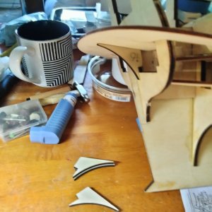

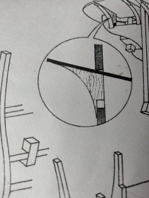

Thank you Coast hiker. It makes sense now. One detail on the ZHL plans is clearly incorrect. The platform should be at a ninety degree angle not tilted up.17610905040738399387119510055638.jpg
Glad I could help! I'll be able to follow in your footsteps when I've assembled enough confidence to start sticking pieces together.
Is the platform the unsual continuation of the deck? If it is, and unless Spanish ships were different than other nations, there was a sheer line of the decks and it was not at ninety degrees except for an area midships. Based on checking a few contemporary plans, English first rates had a deck sheer that created a tilt of about 2.5 degrees to 3 degrees by the time they reached the stern. This is obviously far less than in the drawing you posted, but maybe it was something in between,, but definitely not flat.

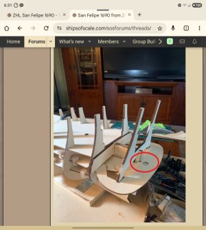

Ted, have you followed the link i provided on your thread first page ?
I took a look to the images of @Scott Shilling built and are similar to yours. Bellow are screenshots.
I have the impression that you are doing the things correctly. Those platforms have an angle as yours.
BTW, those images are on posting #41

I got a copy of the Panart instructions but I interpret them as the decks being level.
Post in thread 'San Felipe 1690 from ZHL' https://shipsofscale.com/sosforums/threads/san-felipe-1690-from-zhl.12404/post-330931

I'm at the point where Scott schilling said he wouldn't glue anything until he was certain it was correct. I'm leaning towards it being correct at that angle.
I'm concerned that if I make a mistake here it won't become evident until much later and past even a heroic effort at rework.
I think I have the correct orientation for the three stern platforms in my mind.

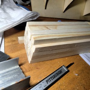

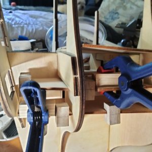

During reading the build logs I became more aware of the problem with the sunny canon supports. I ordered some 10x10mm spruce strips from Amazon. I'm going to fill the entire area on the lower and mid deck platforms to assure backing for the cannons.
These won't arrive until tomorrow.

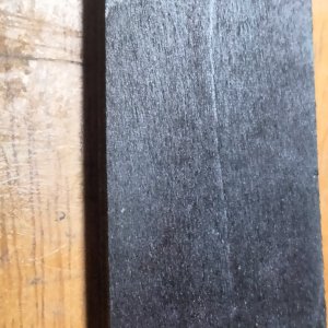

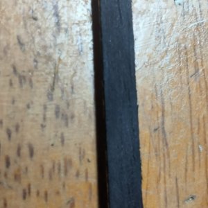

I received the Alcohol ink from Amazon.
It's brownish, like bitumen, with a thin coat. Both examples are two coated. I like itIMG20251023174134.jpgIMG20251023174025.jpgIMG20251023174012.jpg
Got the 10x10mm spruce and started filling in the dummy cannon areas.
$9.99 from Amazon.
