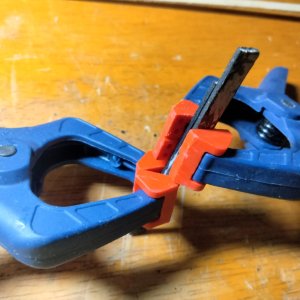

Wetting the frame 12 isn't getting it out.
It was really tight when I glued it so I got exceptional adhesion.
Going to use the wife's hair dryer tomorrow. That puppys coming out.

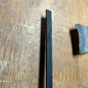

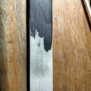

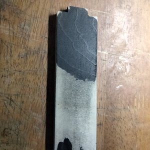

Testing a black vegetable based ink.
Should I be using something else?
Also testing how well it glues with PVA
When I rubbed down the inked area it smudged.
Granted I only waited fifteen minutes, but I'm concerned
The ink I bought fails the smear test. After 12 hours it still smears quite a bit.

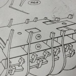

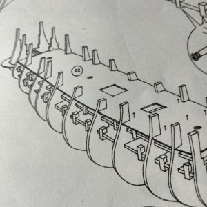

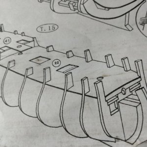

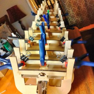

Something is really wrong here. I already trimmed the front of part 51 to move it toward the bow but the rudder. If I slide part 51 aft the gap at the front is much larger than the amount I trimmed.IMG20251020092659.jpgIMG20251020092652.jpgIMG20251020092646.jpg
Im not confident on the three stern deck levels and their angles. I'm also not confident about the dummy gun locations on these three levels. I'm tempted to glue in the main deck subflooring but afraid it will just make more work, or rework.
I read that some have just filled in between the blocks solid. Unfortunately I don't have a table saw to mill the lumber from the sprues. Working with only xacto knives and xacto saws. It would probably take a week to mill these by hand. I learned only to well on the Bluenose build not to go too quickly down an unsure path. Logic says it's time to stop building and do some study.
