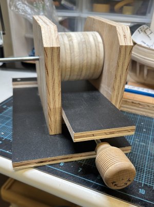

Hello, everyone! I guess it’s been a couple of weeks since my last update on Fair American. Unfortunately, I’ve not really made any progress. After completing the gun carriages, I decided they’re still going to be higher than I like in the gunports, so I’ve been looking at all my options for getting them lower. I’ve raised the breach end of the barrel as much as I dare, but I can thin the deck planks a bit to get some more daylight on top. This of course requires a thickness sander, which has been my main project for the last couple of weeks
Done but for installing the motor and power supply. I’m waiting for a pulse-width modulator because the motor I pulled out of an old cordless drill draws more current at start-up than the laptop power supply is willing to put out. The PWM should allow me to start the motor at low speed and flatten out the current pull.

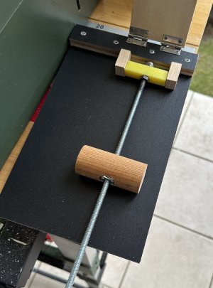

I wanted a simple mechanism to raise and lower the bed that didn’t allow the bed to tilt sideways and could be built with stuff on hand. I came up with this design of a threaded rod running through a really fat dowel. As the rod is turned, it moves the dowel towards or away from the pivot on the outfeed end. I can mill anything under about 17mm, which I can’t figure ever needing to do anything that big for this hobby. [EDIT: I just saw @BradNSW 's great work on his cant frames and decided I can envision a need to put something bigger through this. Maybe a mod due in the future.]

Great design, I may have to copy you on this one. Also, fantastic photo along your hiking route. The view of Mt Fuji in the background is over the top!
Thanks, Daniel. It’s crazy how much smaller Mt Fuji looks in the photo than when you’re looking at it with the Mk 1 eyeball. The human eye is an amazing device.
