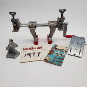

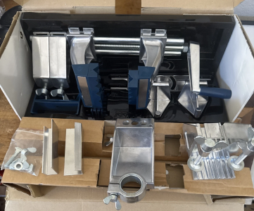

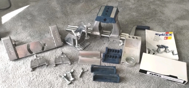

For such tasks, my go-to is a Zyliss vise. (I have two basic vises, plus all the attachments.) This is the original "Swiss Army Vise," being designed for field use by the Swiss Army. (The real army, not Victorinox, the knife company.) This is the most versatile vise I know of in its weight class. It's made of high-strength magnesium and stainless steel for portability and the next best thing to an old Emmert patternmaker's vise, which are now highly-sought-after and . The Zyliss vise will hold anything and the Zyliss "system" can be configured to move a clamped workpiece in any position desired. They were out of production at one point, but I believe they can be purchased new from the present manufacturer in New Zealand under the new branding, "Z-Vise 2" for approximately $230.00 USD. They are fairly common on eBay and local "want ad" websites. You can usually find one for anywhere between $50 and $150 USD, depending upon the extent of attachments included. Note that at one point the real Zyliss vise was "pirated" by an Asian copycat manufacturer who used inferior casting aluminum. The Asian clones are not recommended.
For illustrations of the full range of applications and attachments, see: https://www.homeshow.co.nz/index.html
I grabbed the second basic vise when I had the opportunity to get it cheap so I could have one dedicated solely to holding model hulls. I've never seen anything better for that job!
Zyliss vise, full "system" with attachments, new old stock, (Includes drill motor powered wood lathe attachment,) $130 USD. See: https://www.ebay.com/itm/3891806714...1291&msclkid=4b86c9076a731a9ede8ca0353882a6f1
Zyliss vise, (pictured upside down resting on jaws,) basic vise and some attachments, $40.00 USD / OBO. See: https://www.ebay.com/itm/2056051271...1291&msclkid=d7dc0ce8368a149a55ed65da647b61811764906044466.png
Zyliss vise, full system with all attachments including universal swivel plate and drill motor driven wood lathe, $115.00 USD. See: https://www.ebay.com/itm/3659939144...1291&msclkid=6b11b1f590fc1114e876d8c7c20da947
