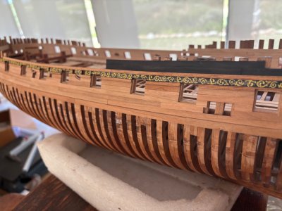

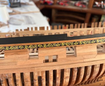

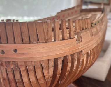

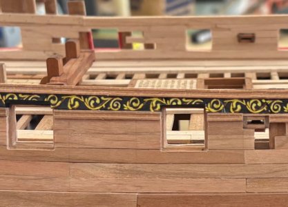

I wasn’t going to post these pics as I have so much fettling to do on the ports - need to square them off and trim some poorly measured planks - ahh nothin wrong with a little WIP.
I add the Friese supplied by the kit - first time for me and it is a lot more fiddly than I expected.
Planked some of the bow also WIP.
One day will present a finished part for you guys but not this dayROTF.
Cheers Grant

Grant, although not finished it looks great. The Friese applied also looks fantastic.
Hermanus must be the place to be ROTF.
Regards Herman
Nice work Grant.
We all have the same story, everytime, every where and every one. The most important thing, you have fun. And we enjoy the progress.
