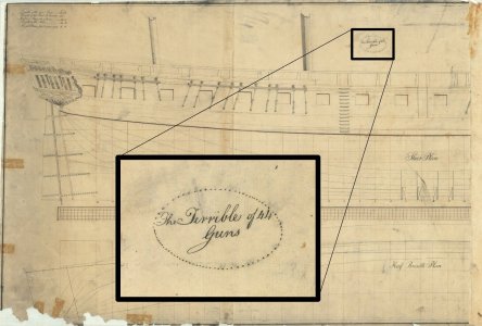

US Frigate “Terrible” — design proposal by Joshua Humphreys, ca. 1796
Apr 26, 2023
683
403
European Union
Actually, this relatively ‘late’ period is beyond my immediate interest in the subject, yet, prompted by a hunch, or rather encouraged by the hull shapes quite characteristic of Northern style of design, I decided to take a closer look at this case as well. Specifically, it concerns Joshua Humphreys' design proposal for the intended ‘Constitution’ class of frigates (many thanks for @Martes for providing this information), i.e. a design from around 1800.
Preliminary tests confirm that Joshua Humphreys did indeed design ships using one of the sub-variants (parabolic) of the general Northern tradition, yet, for greater certainty, a similar analysis can be performed for his 1776 frigate Randolph as well, of which the original plan has been preserved in the archives. Until now, the design methods employed by American shipbuilders of that period were not recognised, and this issue was merely speculated upon by various authors dealing with the subject on premises other than the actual, comprehensive analysis of the design lines. Needless to say, without conclusive results.
Finding the right design method allows for the correction, with unprecedented certainty and precision, of the not very precisely hand-drawn hull lines, which is quite characteristic of manual drafting, and without resorting to clumsy synchronisation of waterlines, buttock lines and cross-section lines in order to make the surfaces fair, and which, as is often the case, still further distorts the original shapes intended by the designer.
In addition, the design method found can also be used for rational and realistic reconstructions of other vessels, based on their known general dimensions, from that time and place, or at least those designed by Humphreys himself.
It can also be added that the plans from the era of captured American vessels, as well as those of other countries, drawn up by the British, although on the one hand may quite well reflect the general shapes of the hulls, and even be quite sufficient for practical applications such as the construction of ‘duplicates’ of such ships, yet, on the other hand, they cannot represent the original shapes very accurately, because for the purposes of making these secondary plans, other design methods were used by the British, which inevitably generated different specificity of shapes, and as a result, only better or worse approximations of the original shapes could be created.
Below are the results of the tests carried out. The red lines, superimposed on Humphreys' original plan (American archives), were generated according to the design method found. As can be seen, they coincide quite satisfactorily with the lines on the plan, except, partly, for the so-called hollowing/bottom curves, which either made some trouble due to their slightly greater complexity to draw, or – more likely – the possibility that in order to speed up the drawing process they could have been drawn in the ‘express’ mode, i.e. without following the formally correct geometric procedures (hence the need for verification diagonals).
The presented results of the shape study are preliminary, which means that the reconstruction still needs to be refined in a consistent manner according to the very precise course of the main longitudinal design lines (after their prior, already more exact determination), which will ultimately guarantee flawlessly fair hull surfaces that are also consistent with the designer's intentions.
As a final note, it can be said that most of the key design lines forming the basis of the project have been removed from the drawing (and, as a result, they need to be painstakingly recreated), leaving only the resultant and verification lines.

To be more certain, I decided to conduct a similar test for the second preserved plan by Joshua Humphreys, namely of the frigate Randolph 1776, which was actually built and had a chance to be put into service.
The results of the test for the aft part of the hull can be seen in the graphic below. Admittedly, the original drawing is not without problems (drafting inaccuracies and subsequent distortions of the paper medium, as well as not quite full compliance with the dimensional specifications of the ship preserved in Humphreys' papers), nevertheless, the conformity of the reconstructed lines with the original lines is very good, and there can be no longer question of coincidence when it comes to the recognised design method.

For greater clarity, it should be added that this concerns a developmental, ‘parabolic’ variation of the design method in the ‘age-old’ Northern tradition (in the European context), the earliest known examples of which date back to the last decades of the 17th century (the French fluit Le Profond 1684, the French transport ship La Belle 1684, whose wreck was recovered off the coast of Texas in the Gulf of Mexico in modern times, or the design of a frigate by Dutch shipwright Hendrik Bindem from around 1700).

Hi @Marcus.K.
Thank you for your additions. Fortunately, this hopefully clearer insight into the date and circumstances of the drawing's creation does not turn anything upside down, as the main purpose of this exercise was to reveal the design method employed by American shipwrights throughout this period, based on genuine, extant materials from that era.
Hmm, Chapelle's statement, which you quoted, that Humphreys did not need and did not like to use plans for shipbuilding, is probably worthy of more extensive commentary, and perhaps even debate, however, his two extant plans speak for themselves quite eloquently.
@Waldemar do you intend to compare the concept plan with the Doughty plan? .. the President "as caught" .. and even the final ship?
Such a comparison of plans of different origins (especially original and British-made ones), which you mention, could indeed be an interesting and useful exercise, but I would gladly leave this task to someone else, because its essence would not be to identify design methods, which is my primary goal, but "merely" to identify the degree of approximation or similarity of these derivative plans ‘as taken’ in relation to the original plans, which normally goes beyond my primary agenda. At this point, I assume a priori that these secondary plans cannot be a reliable basis for recognising actual design methods, and for several reasons, although on the other hand they could be a good basis for reconstruction projects.
I was not aware of the existence of any other American plans from this period apart from those presented above. Could you please provide me with these other plans or indicate a source of sufficient quality for examination?
