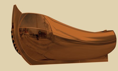

In engineering, the characteristics of a surface are generally assessed according to two criteria: 1) shape errors, i.e. geometric (non-)compliance with the design, assessed by previously accepted dimensional tolerances, 2) the desired (lack of) roughness of the surface, also assessed by previously accepted standards (although these are essentially separate issues, in certain specific circumstances the latter may also affect the former).
For example, a surface can be polished to ‘ideal’, mirror-like smoothness, but its geometry may still be inconsistent with the design. And vice versa.
Therefore, for example, especially if someone wants to achieve a final visual effect in the form of a glossy paint coating, they should take care of both of these characteristics, because defects in both of these categories will have a negative, visible impact on the final result. Or, in other words, the more glossy the final coat of the paint is, the more visually apparent the imperfections in shape will be. Unfortunately.
However, on the other side, this very feature can effectively be used for visual assessment of the correctness of shapes in terms of their fairness, either by covering the surface of a physical object with a shiny coating (even if the surface is ultimately to be matt) or in design computer applications, as shown below:
ViewCapture20230721_231249.jpg​
The above is just to be on the safe side, since some may not be aware of this phenomenon.
