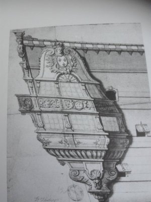

When last we visited I had created a blank for the decoration to be fitted below the base of the quarter gallery. Here is the part I am talking about on the Magerotte model:
If I were to make this part again, I would make it differently - the end-grain facing the stern of the ship was very difficult to work.

One remark, is it correct that the shapes are all in the same vertical axis? I would expect the vertical axis of these shapes is tilting a bit for every shape from fwd to aft to get a nice natural flow and a much better look of the final side gallery. The position of the vertical axis should be in flow with the above positioned panels. The flow of the lines in these galleries can make or brake the look of your model. I would double check it in the drawings.
See below what I mean.
Just a remark :-)
