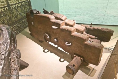

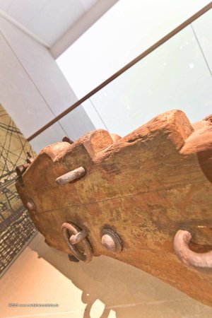

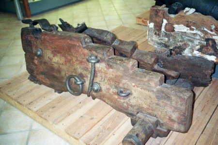

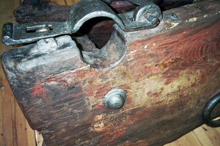

It depends on the period in question. If we are talking about the time before 1800, gun carriages were coated with red iron oxide paint. This paint is red in color; it is a special coating that effectively protects both wood and iron from the effects of seawater.
That is why all the structural elements of the hull, as well as the bitts and bollards, were also painted with red lead primer.
In addition, iron oxide red paint possesses high fire resistance; therefore, gun port covers and frames, as well as gun carriages and the muzzle sections of barrels, were painted with it.
From 1800 onwards, gun carriages were painted with mineral ochre over the layer of red lead paint. This ochre was yellow in color (the specific shade depended on the quality of the ore and the quarry from which it was extracted).
Mineral ochre is a highly abrasion-resistant paint that provides excellent protection for wood and iron against seawater.

In the photographs: gun carriages dating from after 1800. Yellow mineral ochre has been applied over red iron-oxide primer.

well it appears the overwhelming majority vote for yellow ochre. My taste in colors doesn't find that shade appealing it will probably end up that color. I gotta say say though it's better then salmon on a a ship this dignified.
