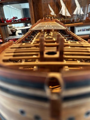

Good morning. After filling plenty swear jars …….I mean plenty, I think my fight with this Frigate ended in stalemate.
Some pics- final sanding of the beams, carlings, knee tops etc still to be done: looks a bit raw at this stage.
Pics:
Overall view :
Different angles :
View attachment 622458View attachment 622460
Close ups :
View attachment 622456View attachment 622457
Hinges :

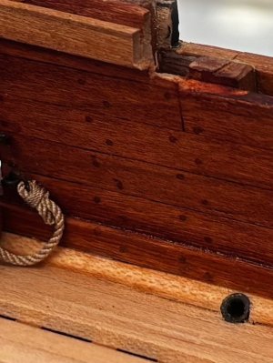

Scupper which I placed incorrectly…..should be outside the removable bulkhead….Oops.
Scuppers in the manager- still need to insert lead simulates.
Cheers Grant

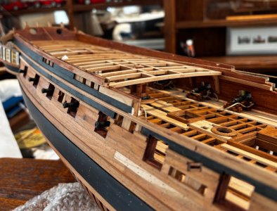

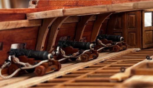

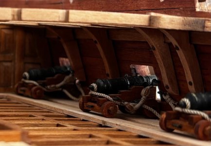

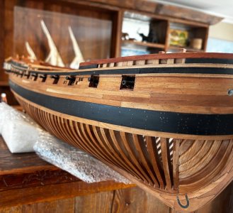

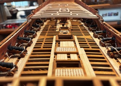

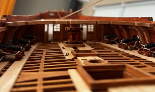

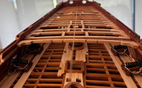

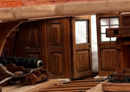

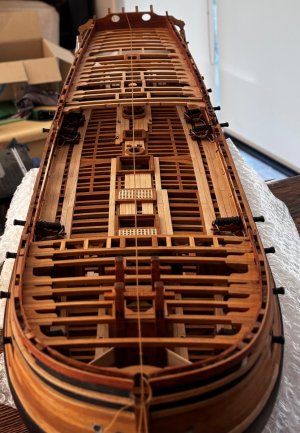

Beautiful! Love the natural color of the woodGood morning everyone. I have had some time this week to play on my ship- not much tho.
Pretty much more of the same- more deck beams, knees etc and cannons. This time on the quarter deck.
Just some pics :
View attachment 625441View attachment 625442View attachment 625443View attachment 625445View attachment 625450View attachment 625451
Broader views:
View attachment 625452View attachment 625449

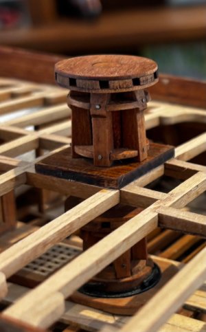

For ease of building and final sanding of the beams, I decided to cut the capstan in two. If I put the upper deck portion on it will look like this- I don’t like the kit base so I will change this much later.

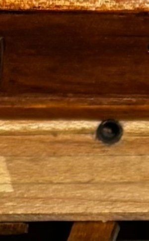

The scupper holes I make from 2.5mm brass rod, flatten to make a bit of a flange. Blacken just once to keep in line with the look of the ship. I couldn’t bend this to the shape of waterway, however they look ok.
Cheers Grant
Some nice inside pictures, nicely added details and ongoing rigging, Grant.Good morning everyone. I have had some time this week to play on my ship- not much tho.

Wow, I just love the detail, Grant. Especially the through bolts in the hanging knees and not to mention the waterway drain scuppers.
Magnificent results Grant, I love the "below deck" pictures; beautiful rigged canons.

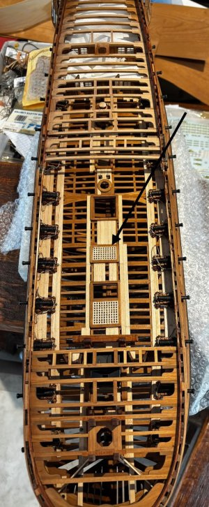

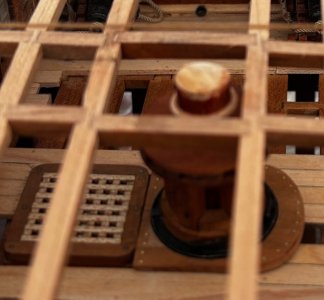

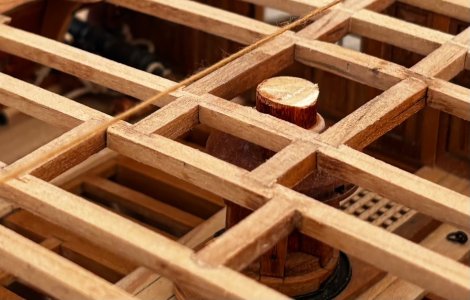

. I can live with the multiple little inconsistencies however the arrow shows my middle grating and corresponding deck planks being a problem child . I can’t believe I haven’t noticed this - I hardly see this with the naked eye- Eish a redo coming up.
