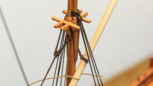

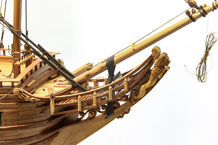

In respect to look and feel compared to cotton, have a look at @mati.n pinnace, he uses poly ropes and is work is really from another place, just perfect.

I'm sorry, in the enlargement the ropes look like steel ropes. Perfectly assembled indeed - too perfect for my taste.

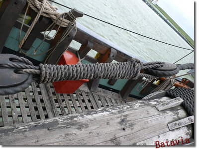

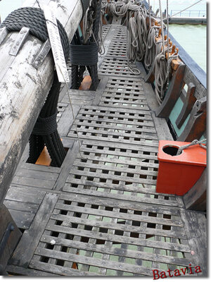

Nothing so personal as taste :-) , but comparing mati work to the real deal he is pretty close.

Nothing so personal as taste :) , but comparing mati work to the real deal he is pretty close.
View attachment 226422View attachment 226424View attachment 226423

Hi Maarten, of course, on the one hand it's a matter of taste. As I said - this is really excellent craft, chapeau. On the other hand, that's not necessarily what I personally mean by "historical model making". No plastic belongs in such an exposed place. Of course, I also use all sorts of materials to give the most accurate or approximate impression possible. We have the saying "it has to look like but it doesn't have to be". I usually stick to that. Your photos of the Batavia confirm that - that is today's material. Of course, what else. Nobody would think of using 1: 1 replicas of the Santa Maria ropes made of sisal these days, as was the case. It is the sheen of the material that I find "unnatural".
