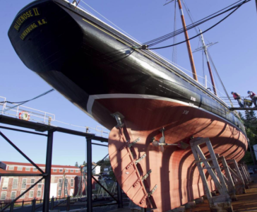

4. I found this picture of the hull in the Lunenburg shipyard during its restoration, 2010-2012. It has such a wonderful profile that I immediately decided to ditch the A-L instructions and try to get the model looking like it should.
