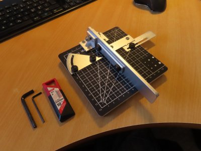

That said, this is one from AliExress that looks pretty much identical to one I purchased for about six times as much money. It actually works pretty well, once you figure out how to set it up. I've used it to cut stock as large as 4x4mm walnut, and that's pretty good. The bigger remaining challenge will be how to actually change the blade when the time comes. That part doesn't seem so intuitive.

I have an el cheapo cutter from ModelExpo and it works fine…the secret is to keep a sharp blade in place and keep it adjusted. My el cheapo takes one sided razor blades. I change them fairly often. So far it is working except for very hard woods…it that case I use a hobby chop saw…just my experience…
Got this one today with the mail, ordered it about five weeks ago from Grichs, via Facebook. Was a bit hesitant as it didn't show up, but it finally arrived. Looks and feels very sturdy, so I'm happy so far. Now just waiting for my broken fingers to heal so I can get back in to cut wood again. Cost me about $55, freight included. :)
