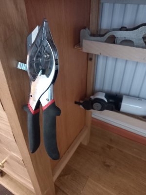

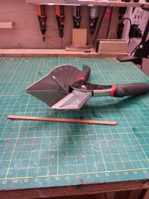

I find this cheap option works fairly well - e.g 2 x 5mm sapele no contest. It has a zero footprint and hangs under my bench when in active use.
Uses standard "Stanley knife" blades.
