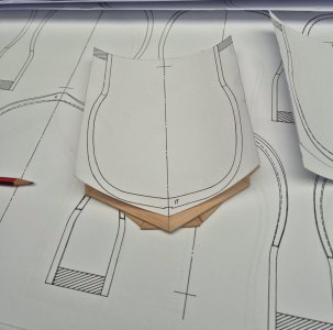

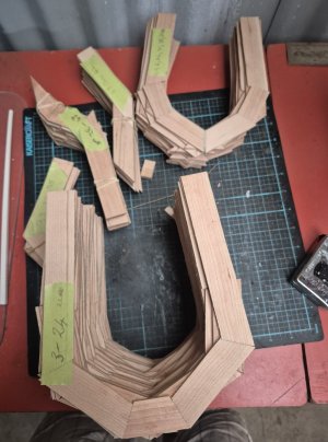

So, all, I have done a bit of work on the model and have built all the frames, well, the fitting of the rough shape outlines of the frames at least. At first, and on the first set of frames, I blind folded myself when I built them. There were a few slits where the wood sections did not quite fit together. Then after that, I used my cutoff saw and, with clamping, had great success. First, I used the Proxxen Saw, and cutting at angles proved to be very challenging to set up and maintain due to the slight movement of the wood stock against the angle of the blade. Here they all are.

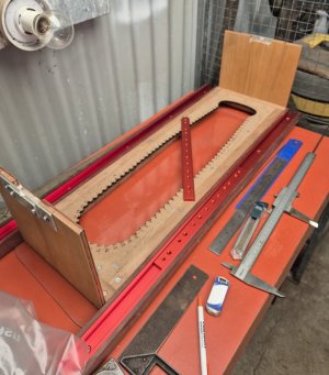

So, after finishing the frames, I took a look at the Framing Jig sent to me, and it seemed to be so accurately made, it was a wonderful experience to have this jig made, as I thought it would be a huge stumbling block for me when fitting these frames and keeping the angle smooth and true.
I spent a fair bit of time searching here on SOS and also on the web, and one of the members of SOS had included a video on how a certain individual had advanced the Harold Hahn build in regards to how to use some clever ingenuity to help make building the ship's hull, little easier.
I am going to follow similar lines with this build, following engineering and also the techniques of old to accomplish the accuracy of the hull shape.
So, what I have achieved so far is to find out what height the frames will be, and I have added a centre line X-Y bracketing that can be moved if needed, and then I lock it into place once it is correct. A weighted string line will be attached, and that will be how I keep the alignment of the frames tracking correctly, hopefully.
Although not shown in this photo, I will include the teebar and slots to accurately hold the frames square and true.
For the jig to sit and lay straight and flat, and after checking the table for bumps, I laid a piece of glass, 6mm thick, down and carefully checked for flatness, and is certainly flat enough to not cause any hindrance to the build.
I am also going to have a clamping system fitted to the end of the framing jig to hold the keel and bow section in place, so I can learn to work around this and not destroy the model with overexertion if that comes to mind.
Any suggestions will be welcomed.

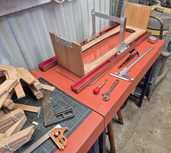

Back up at it now, spent the last couple of days setting up the Hahn's method with additions.
The photos show the Tee Track and Mitre Track installed into a piece of machined wood, and still within my accuracy of 1/2 a mm, and I am pleased with that.
I am now making the gantry setup for the tee tracks. I don't know if I'll use them, but I bet they'll come in handy as I go along. You will notice the Tee Track is longer than the platform for the model. Not a problem, if I build another model and need more length, well, the more length is not in the bin, but still attached to the original.

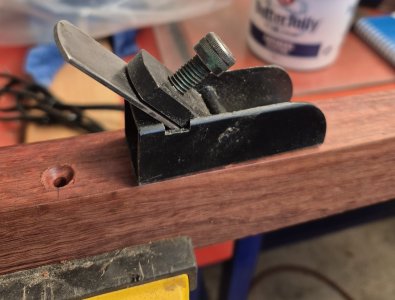

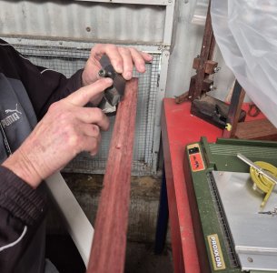

I also took a pic of my miniature hand plane that is the bees' knees for very small planing work.
Any comment, feel free to write them to me.
Here I am putting a very fine edge on the machined Jarrah wood I am using to hold the tee slots.
A photo of my homemade U-Beaut miniature Hand planer:
Here is the Tee Track installed on the jarrah runners and fitted to the jig.
Next, I will be fitting the gantry to the Mitre tracks. Stand by

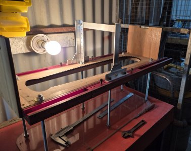

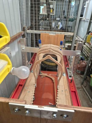

My latest update to this log:
I have finally finished making the frame, complete with the gantry, which turned out rather well. I also added extensions to lift the working height to a level I am comfortable with.
Gantry fitted, and the accuracy is very close
The Frame, complete with legs. The reason I wanted to put leg extensions on is that if I need them, I have the holes drilled and the threaded bar cut if required. Also, I can turn the gantry to work the other side as I remounted the teebar and the wood section to be turned upside down or traversed 180degrees. The caphead bolts are to lock the tee bar into position. :

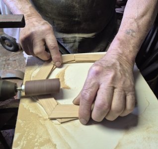

Moving onto the frames, and here is my drum sander working to its best to machine the excess material of the frames. I am extremely happy with the way it worked, and the results were nearly first-class. I did add an extra base to the stand so i could easily turn the frames to follow the grain
I will insert the video on how I use the Sander:
View attachment Drum Sanding the frames.mp4
As you can see here, I use a rotating approach to the Drum sander. What I have found out if you try to run the frame in a continuous pass, then on a heavy cut will cause clogging of the Drum. I do quite often use the rubber cleaner, and that works fine too, when cleaning the drum.
I have found the 80 sanding grit works better than the 140, as the dust will clog the drum grit quite quickly.
Also, on top of all of this, I have maintained good accuracy on the thickness of the frames.

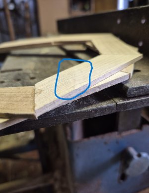

The next photo shows a circle around the depth of cut I am taking for the first cut, around 0.020". Maybe a bit hard to pick up.
There is a slight difference in the thickness of Cherry, but that's expected.

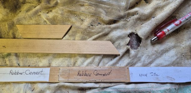

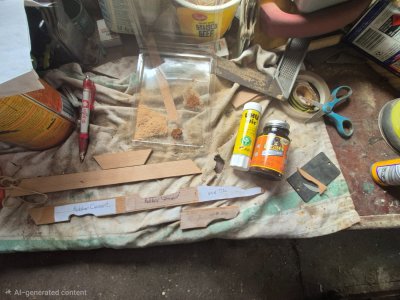

I set sample gluing on a piece of cherry to find out what would be the best glue to use. I used Rubber cement and also a glue stick made in Germany, but the Rubber Cement worked like I wanted it to, where I could peel off after I used the jigsaw to cut along a line. The rubber cement worked well as it did not stick as stuck, but was firm enough to hold the paper to the cherry strip. Thanks, Dave from the Lumber yard, for your information regarding the Rubber Cement.
What would you suggest to remove the residue from the wood, Thinners?

Making steady progress with the frames, and I can see the shape of the hull starting to appear. Progress is a bit slow at the moment, as I am undergoing alterations to my house, and it's very challenging to achieve the quality I want while meeting the standards that are supposed to be met with the tradespeople.
I am only dry-fitting them first (No Glue!) I use thin paper so that the fit in some cases can vary a very small bit. The string line is working substantially well. I have also made up the keel and forward and aft sections, also glued together.
You could say making steady progress.
I can say now the gantry is going to work a treat when it comes to setting up and gluing the frames.
Also, the height of the model is at an exceptional height where I am standing up, but I can easily work the frames into their slots with ease, and run my eye down the string line to see how everything is going.
