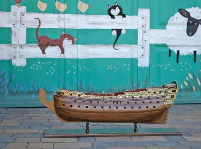

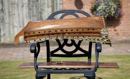

Continuing, I fitted the rail capping using 4 x 1 mm strip, using my soldering iron to get the curved ends, again it worked well.
I also touched up the red port linings as they were looking a bit jaded and cleaned up the hull. I also couldn't resist putting on a first coat of diluted poly. I wanted to see how it would take after all the glue that had been spilt on it before deciding whether to paint bellow the water line or not. The good news is that it went on perfectly with no staining issues, just a lovely even colour of the wood, it looked great so the decision was made to leave it a natural wood finish.

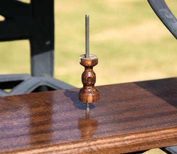

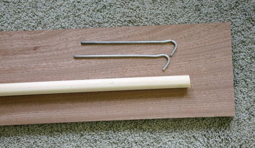

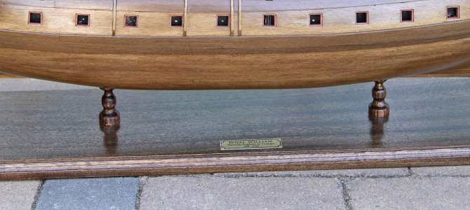

I decided not to use the stand provided so got I nice piece of mahogany to use as a plinth and routed it, I used an old broom handle for the columns which I turned and some tent pegs. I stained and varnished it, I think that the pictures are self explanatory.
